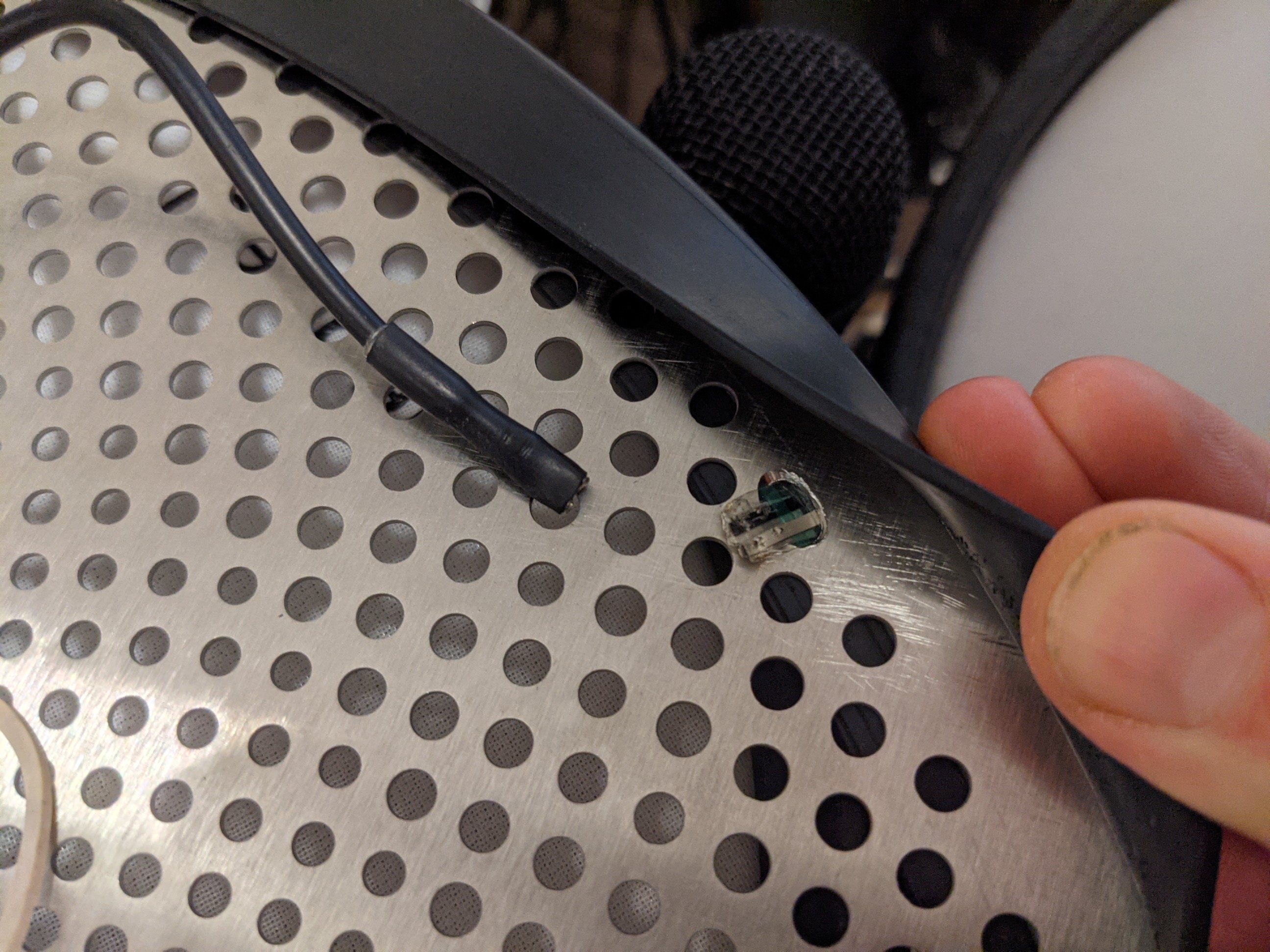

Re: DIY cymbal advice
AKA Wayne wrote:
Just curious, how do your myrks keep breaking? I haven’t had on break yet but I’m not a hard hitter or play nearly as much as I’d like to.
They've all sheared where the metal prongs meet the plastic. I can't work out why, as I cable tied them down and used shrink tube to hold them.
I soldered mine, which may have caused a weakness as I've since read that you can put some sort of prong fitting into them? Myrk's fitting instructions left a lot to be desired.
Most people don't have issues, so I'm happy to explore these again if I get some clarity of best method to fit them.
