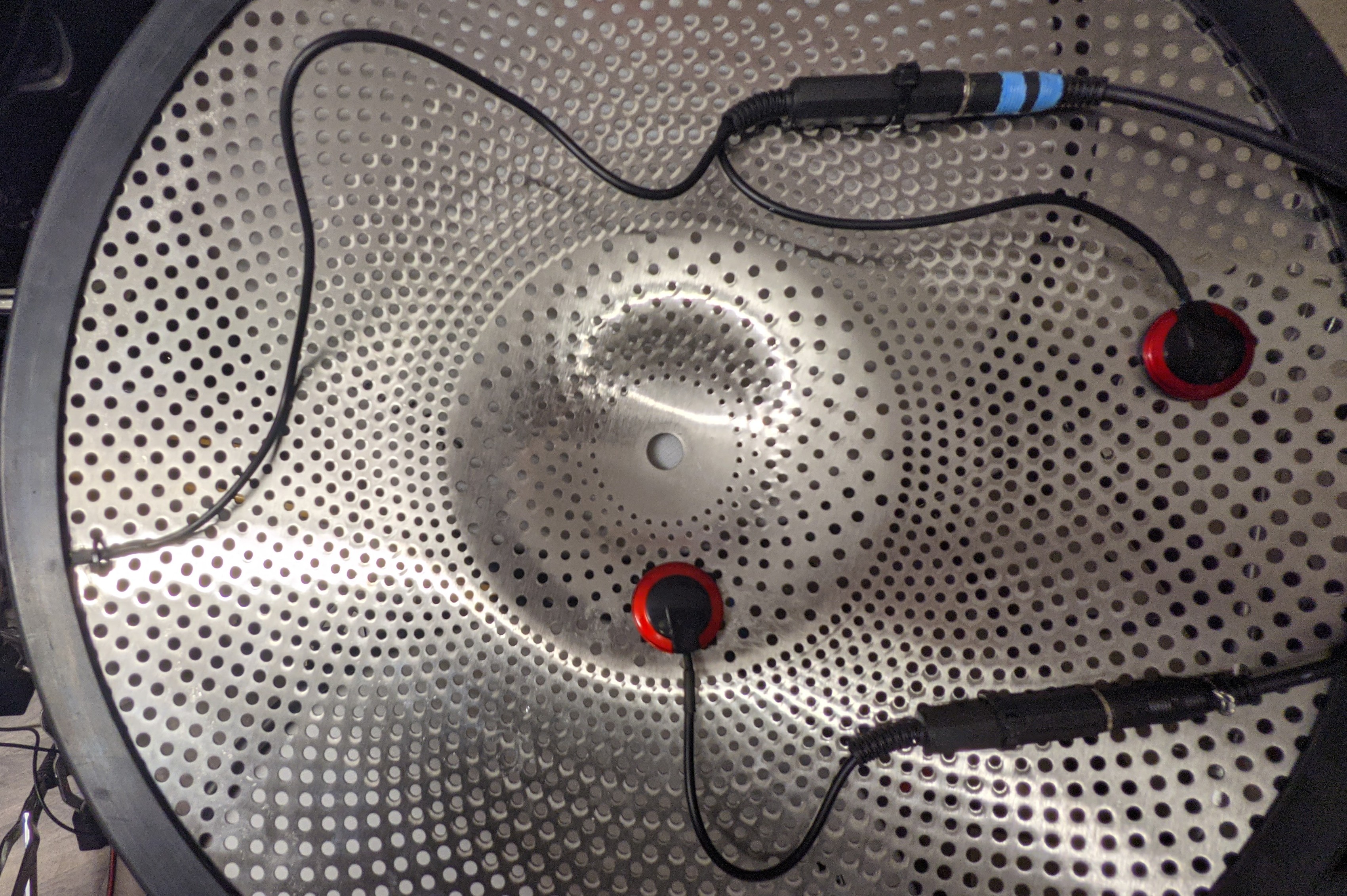

Hi Frank.
For a DIY 3 zone metal cymbal, you have 2 options:
Yamaha wiring or Roland wiring.
Yamaha wiring, can operate on single stereo jack cable, using a piezo bow, edge switch (myrk or similar) and a switch bell on a resistor. See wiring diagram in the manual. Note, the bell switch must be mounted on the top.
Pros, one jack. Cons, ugly build IMO as the bell switch is on top.
Roland wiring, needs 2 stereo jack cables and uses 2 inputs.
Stereo jack cable one, piezo bow and edge switch
Stereo jack cable two, blank and piezo bell. (Rob has recently made a change so you can make use of the blank side with another single trigger input)
Pros, neater stealth build. Cons, requires half an input more than Yamaha wiring. Note, you link the bell input trigger to the ride in the eDRUMin software (I think it has to be the next one). This allows for the bell to work instead of the bow, rather than the same time, and the edge switch can then also choke the bell (in SD3 at least).
My ride build is here, using Roland wiring (bell piezo is wired to the right side of a separate jack cable):
I thoroughly recommend you watch the Project Beats videos:
https://youtu.be/UKfHCBNN2Kc
- Rob's comment regarding bell and edge sense, isn't relevant here for either wiring schemes. They are special eDRUMin functions that allow bell / edges to be recognised using a single piezo! They apparently well only on branded rubber cymbals, although some users have reported some success using metal cymbals, but you'll need to set the input to rubber to enable bell/edge sensing.
