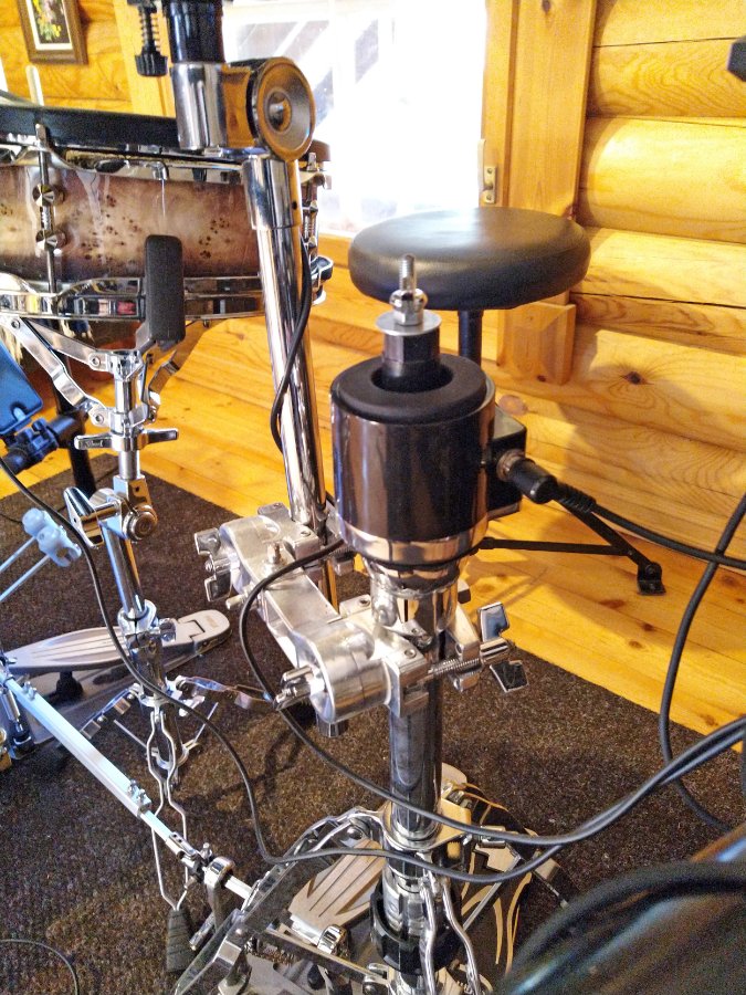

Re: 2 piece hi hat
This worked best for me, only top hihat is used and controller is in hihat stand, very little movement is needed in pedal.
And better positioning with double pedal.
- 004.jpg (210.94 KiB) Viewed 1077 times
