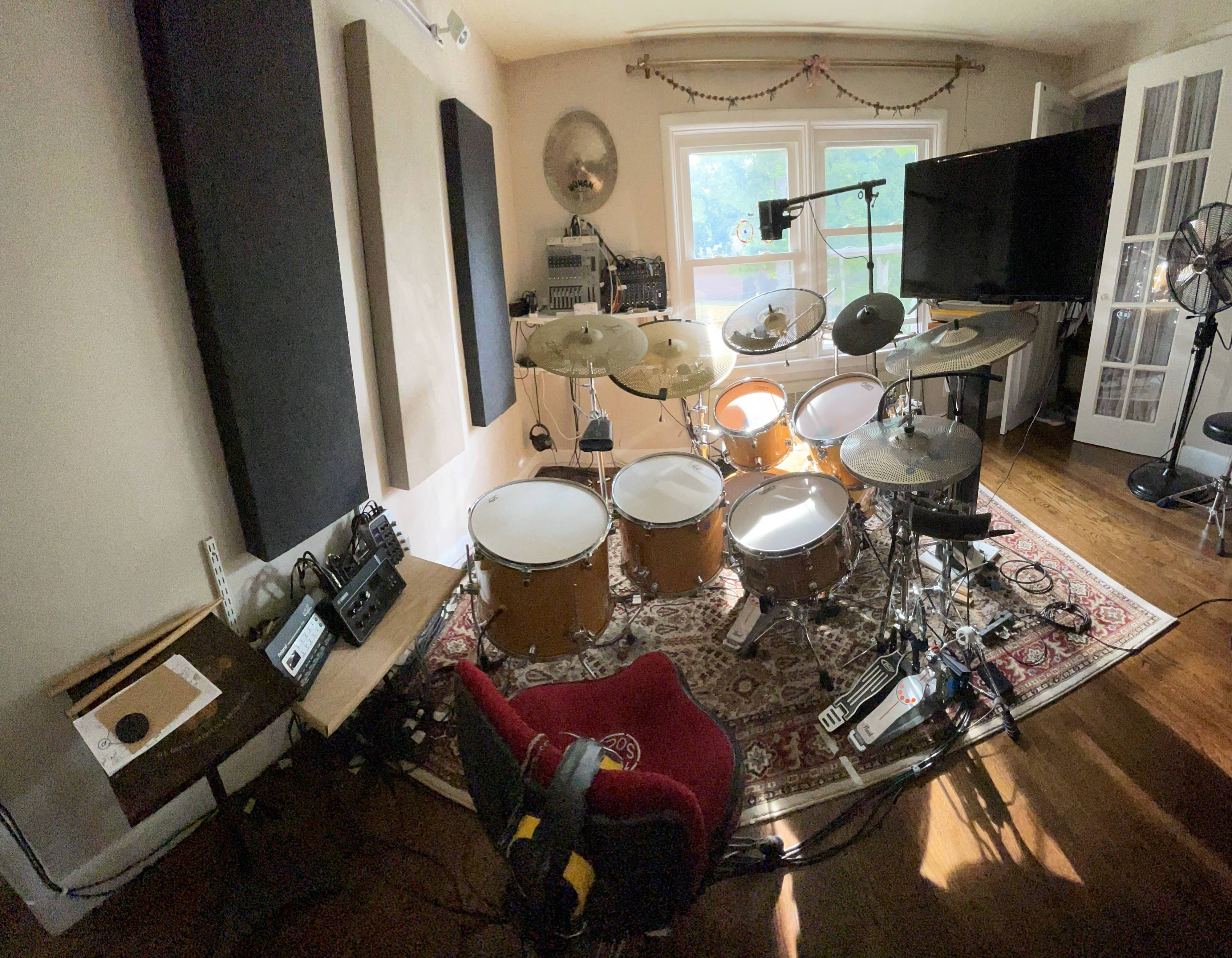

My low volume mapex pro kit. Yamaha EAD10 handles the toms and kick. Roland TD3 for kick 2 , snare and cowbell, 2 crashes. Gen16 forvrest of cymbals for now. In process of finishing triggering the 3 zone ride and hihat . But waiting for edrumin shipments in fall to rid the td3, Gen16, and possibly the EAD10.
Drum triggers diy’d. 14 and 16 floor toms have 3 edge trigger formation for better triggering. 10 and 12 toms i use single sidemount since smaller head real estate so triggering is good. Snare center mounted.
Ead10 and td3 midi to macOs running Addictive Drums 2 and Reaper. Gen16 connected to mixer with usb. For recording, Addictive drums 2 plugin on channel 1, gen16 channel 2. No issues.
Really cant wait to get my hands on the edrumin modules. Edrumin10 pushed way out so guess I’ll buy 2 edrumin4.

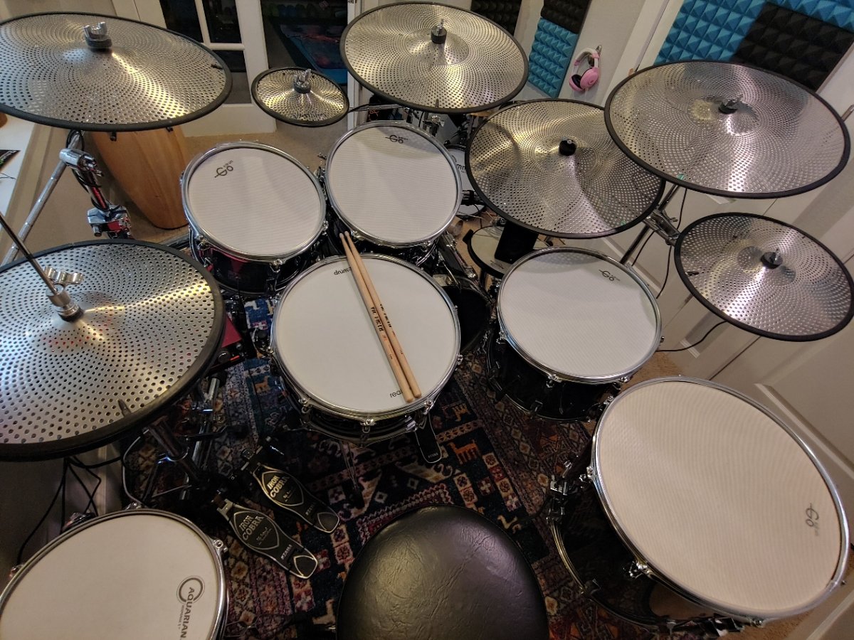

It's the Yamaha one with integrated cymbal mounts, not sure of the exact model.
My build has changed a little now, an extra floor tom and now using Lemon rubber cymbals - got fed up of fixing things!

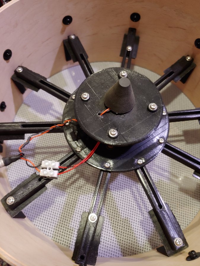

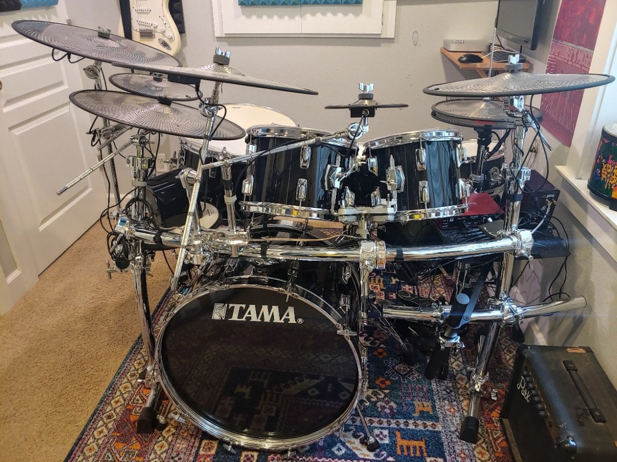

The Kit: 1984 Tama Imperialstar. Designed and 3D printed my own dual zone triggers. Snare has all ten lugs connect to trigger, the rest of the toms have four. Standard 27mm piezos on head and 35mm rim piezos. Quartz cones, they're the best and totally worth the money.
I'll go into the rest tomorrow. I'm getting sleepy.

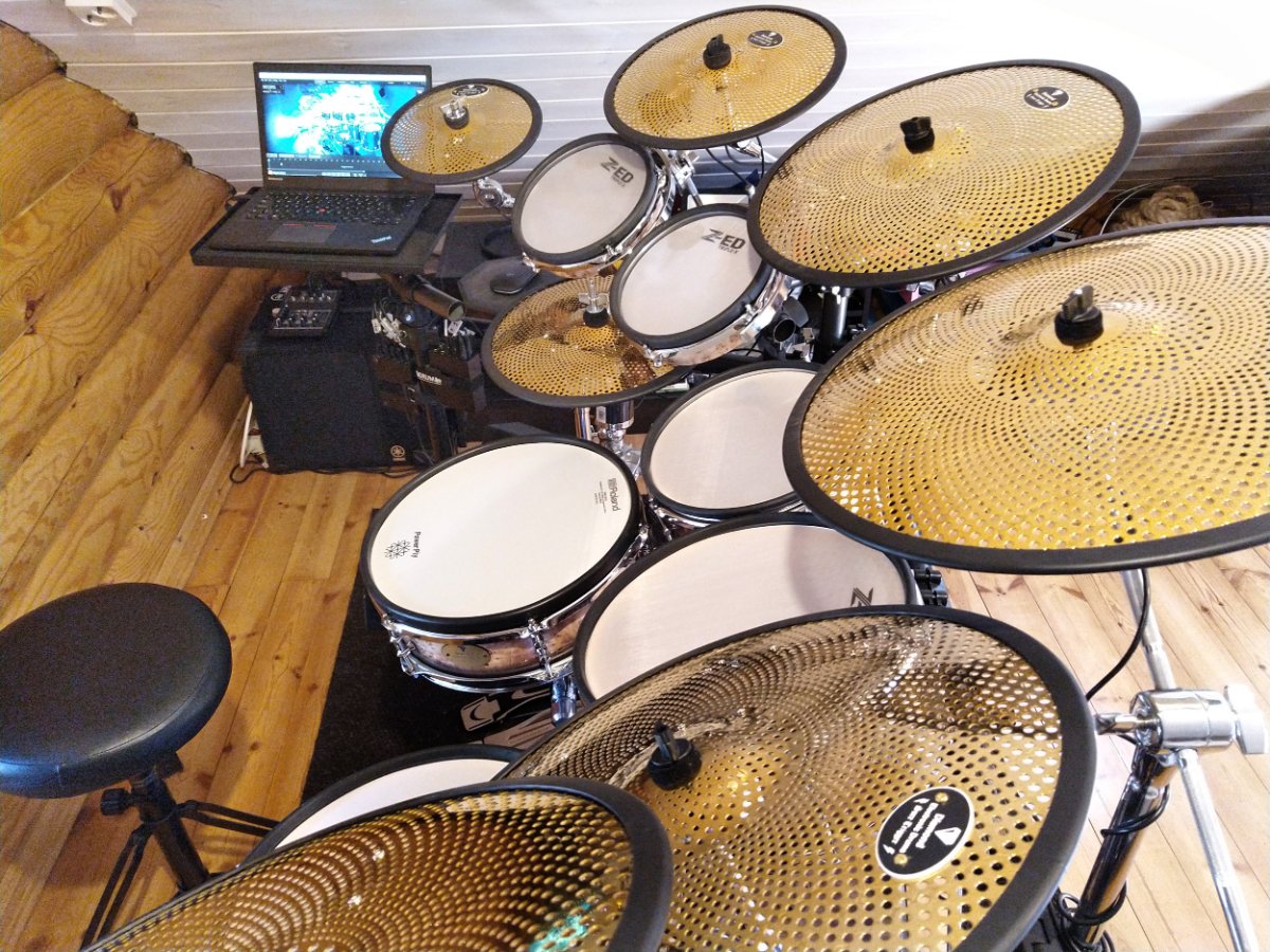

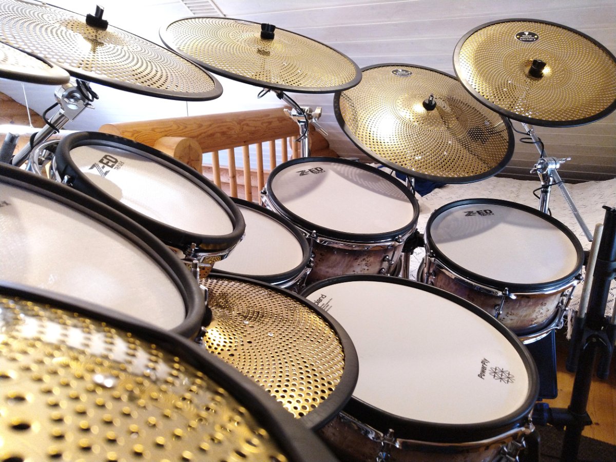

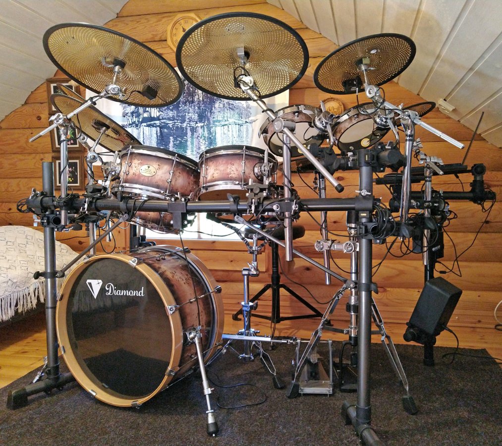

Here´s my set..
Diamond Drum kit with low volume cymbals, two eDRUMin 10

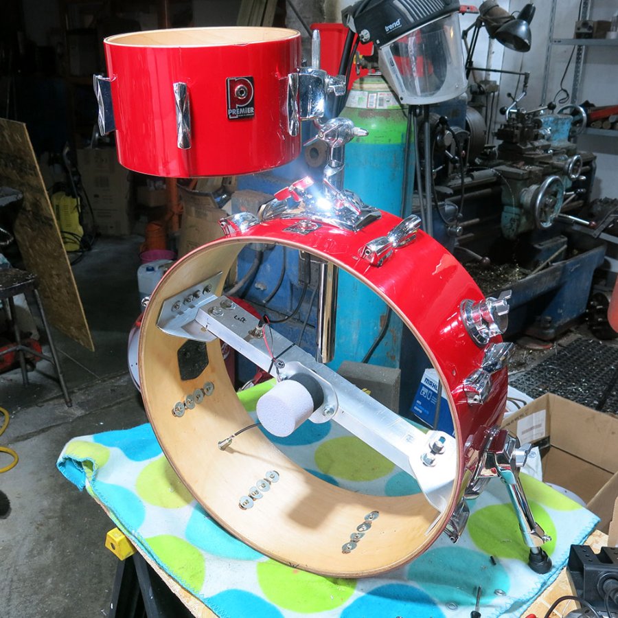

Premier A2E conversion - a mix of 70s/80s/90s Premier parts I had lying around: 20x8, 10x6, 13x11, 14x12, 12x5 snare
eDRUMin 10
Lemon cymbals: 2 x crash, 1 x 3-zone ride, 2pc hi-hat
Heads: Roland MH2 Powerply on snare (for excellent PS), Jobeky tri-ply on BD & toms
R-Drums Monogon trigger on DIY aluminiun mount

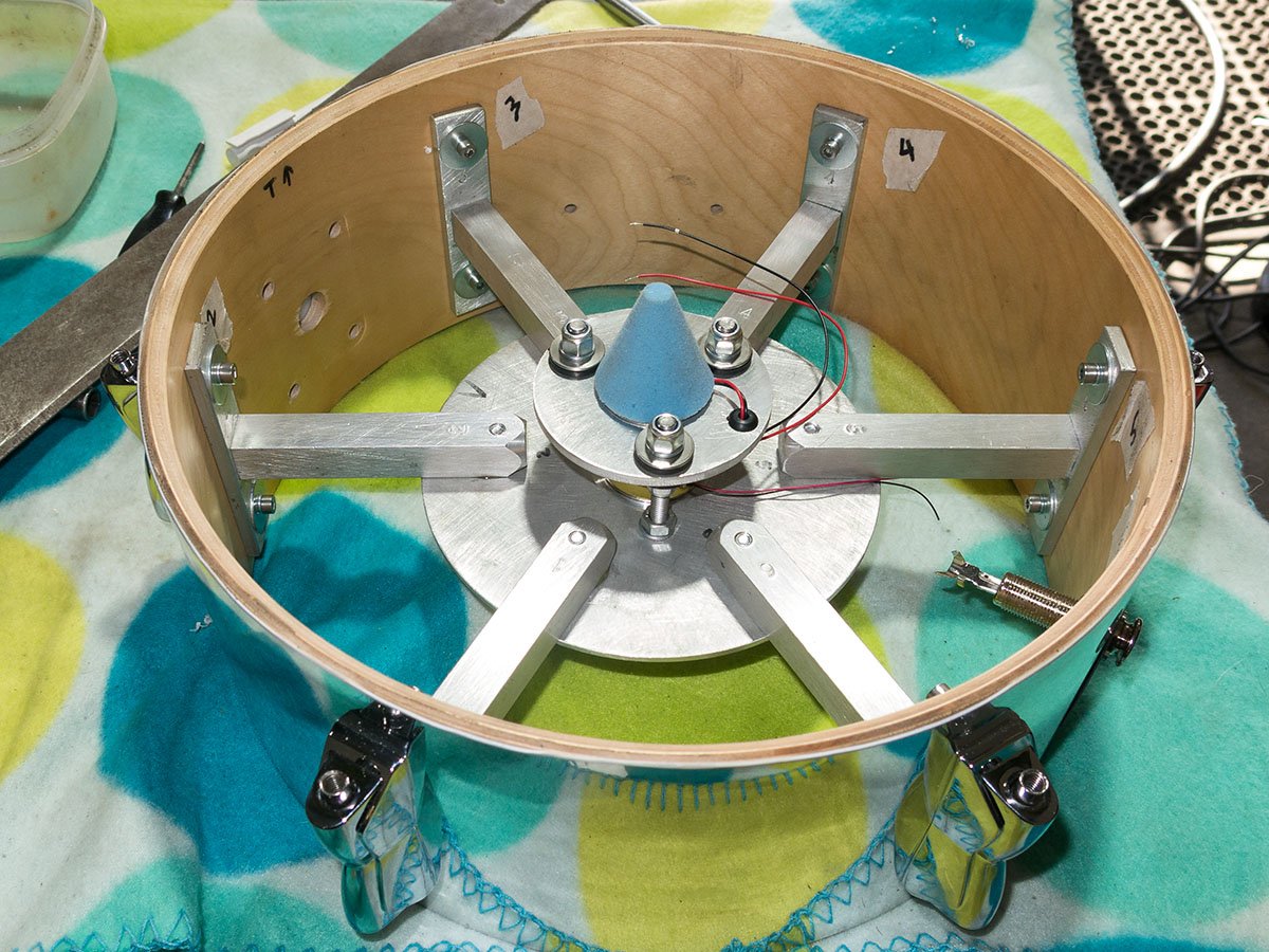

DIY two zone snare trigger and mount
