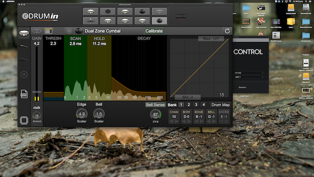

Currently only getting bow triggers using Dual Zone Cymbal as my input.
Having the same issue with the ATV 12" hat, 12" crash and 14" Ride.
I have had more success switching over to mono input and using edge sense, but still registering occasional bow hits that are way over the other side of the scale. I hope that makes sense.
I feel like I am missing something.
The cables are TRS, they are fine. The inputs seem good, I have tested them with drum pads.
I watched setup videos and trawled the forums here, nothing seems to work.
Any ideas?

No ideas. What version are you using?

1.3.0 build 28.
I have it semi workable in mono with edge sense. The bow hits seem to fall in the same range consistently but the edge hits are all over the place.

Oops. I just realised you might also have meant which hardware. eDRUMin 10 black.
Posts: 4904
Re: Having trouble setting up ATV cymbals.
Should be working fine with the dual zone cymbal preset.

Can you attach a screenshot of your settings?
Posts: 4904
Are your inputs set to stereo? Maybe you accidentally changed it to mono or dual mono.
I have ATV aDrums Artist cymbals and I get all three zones using one TRS cable. I have them set to Dual Zone Cymbal with Bell Sense turned on set to CY-8.
When using one cable, on the cymbal the cable MUST be plugged into Edge input.

I did some messing around and I have the hi hat triggering the edge, but can only get the bow in specific spots if I really belt it.
The ride and crash I have both edge and bow triggering now but it's still quite inconsistent. The bow triggers consistently, but the edge jumps around the meter.
I just tried bell sense, seems to trigger fine when I hit the bell directly, but the edge is triggering all 3 zones seemingly at random.
I feel like I'm doing something wrong, I got the drums and hi hat pedal set up without issue.
