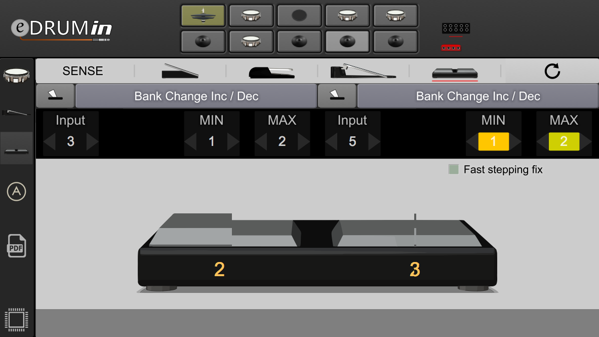

So I got that double latching pedal but something is weird.
What I'd like to do is use Switch 1 on the pedal to control banks on eDrumIn Input 3 (high tom vs low tom in SD3) and use Switch 2 to change Input 5 (splash vs china cymbal). Seems like a pretty straightforward use case.
It only sometimes works. But it's random: sometimes switch 1 changes input 5, sometimes switch 2 changes input 3. More often, nothing gets switched at all. And when I step on my hihat, the bank numbers on the right light up, as if they were chick/splash indicators. I've reset the input settings and tried a few times, with the same result.
Screenshot:
Screen Shot 2020-08-25 at 8.20.01 PM.png (170.14 KiB) Viewed 1559 times

I fixed some ED10 pedal sensing issues with 1.3.0.11. Have you installed that version?
