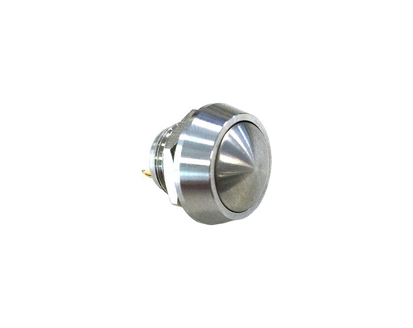

Im running a two button footswitch next to my kick pedal that lets me switch between 4 different kick drums and also In the throws of trying to design a switching system to mount into my snare to allow me to cycle through 4 different snare drums. This is a game changer for me as reaching for the mouse just ruins the fun of playing. Couldnt do it without SD3 though. Who has a 4gb kit loaded with 4 kick drums and 4 snares?????? lol. Brilliant software.
Ill probably use this switch mounted in the vent hole of my ludwig converted snare to change banks. Ill fit the two 1/4 inch jacks to the bottom reso head. I really just want to avoid drilling un neccessary holes in the shell.
https://au.rs-online.com/web/p/push-but ... s/1278499/
- _mp12_img_2496-domed_9_1.jpg (16.65 KiB) Viewed 1519 times
