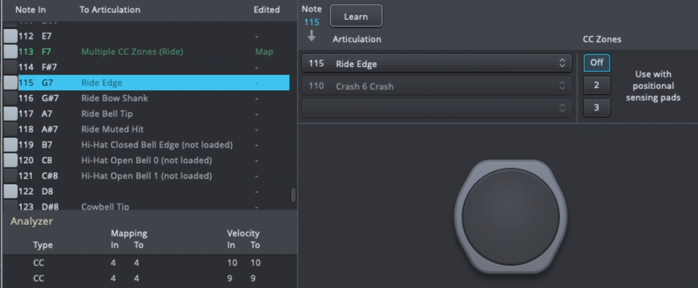

I have a 3 zone ride comming into my ED and the hits seem to match up to the notes just fine, (I would like to expand the bell area if possible so it isn't so small on the physical ride,) but am having no luck in assigning the edge in SD3.
I have the edge sound loaded, but I cannot figure out how to add a note in SD3 to the edge crash.
I have tried adding it to Bow Tip Edge 2, which I assigned to 113, but it stacks it and messes up all my midi notes.
I really just want to assign a note to the "edge" note as seen in the image but cannot figure it out?
I just want to crash my ride!!!!
Thanks!
EDIT:
So I think I am figuring it out, I can click on the 3 horizontal bars at te right side of the midi notes to assign the sounds with no note.
Sometimes it works, and seems to if I set each zone as its own note, but I "think" I am supposed to be setting it to 3 zone, not 1 zone in here right?
I can't figure this part out.
Am I supposed too be adjusting the cc value here?
