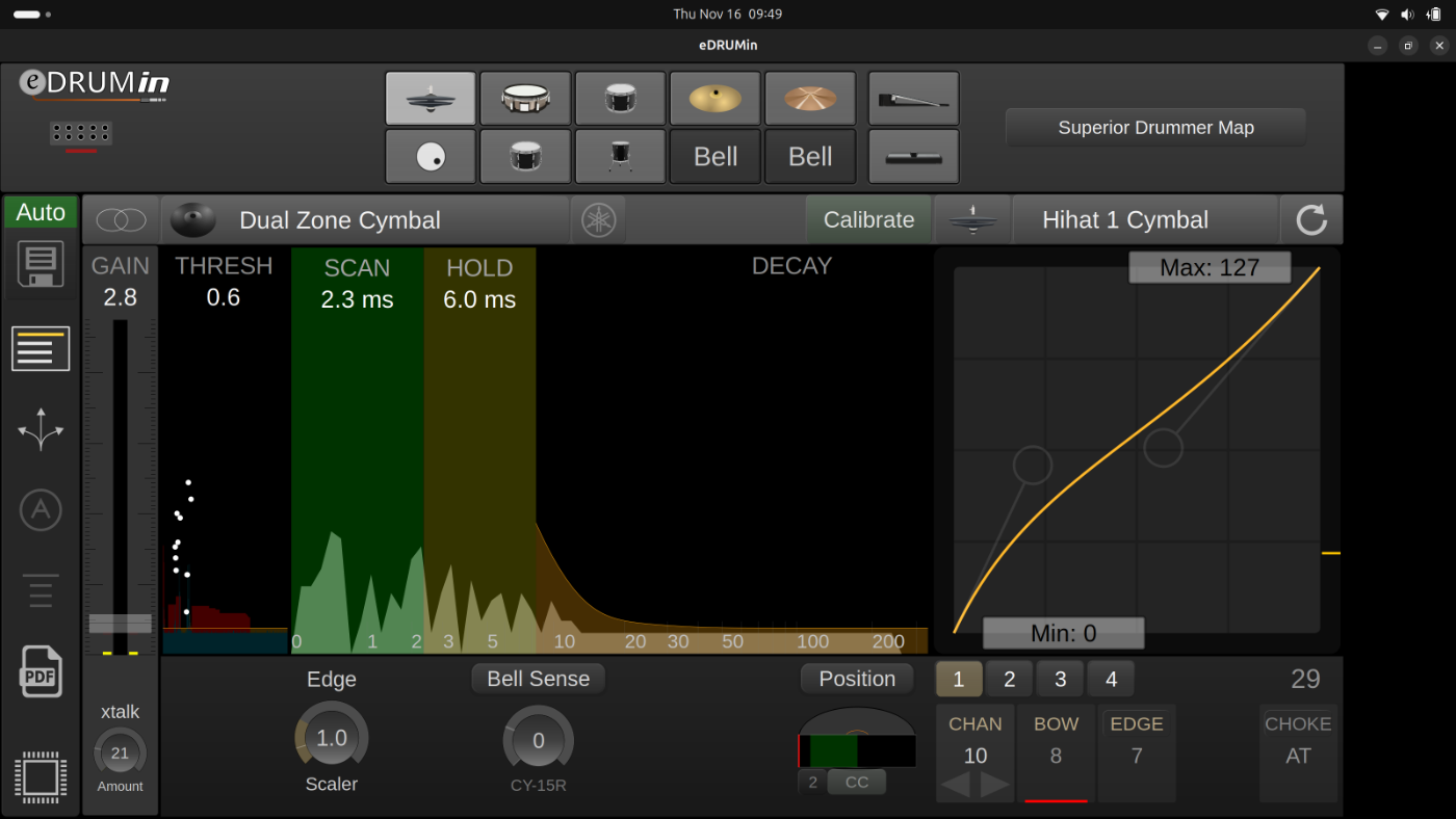

However, I can still get into this blocking situation for both the pedal mode and the new stand mode (see screenshot). As a slight improvement, it seems to "unblock" faster than before after small changes to the pedal position.

Thanks for the feedback. I noticed the freeze too. I found a possible divide by zero hardware issue causing a crash. I've fixed it already, but I need to give it some more time to make sure that I really fixed it.
Re: eDRUMin version 2.3.1 BETA
I posted build 1 which should resolve the hardware crash.
I posted build 2 to fix an issue where 'stand' mode wouldn't send notes after calibrating.

Seems to be much better now. Thank you!
