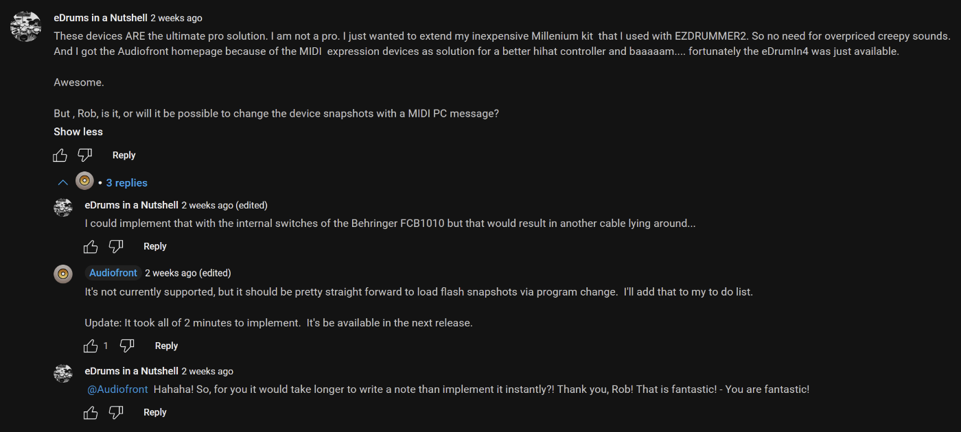

  • Flash Presets can be loaded with program change messages. (Channel 14, programs 1-32)

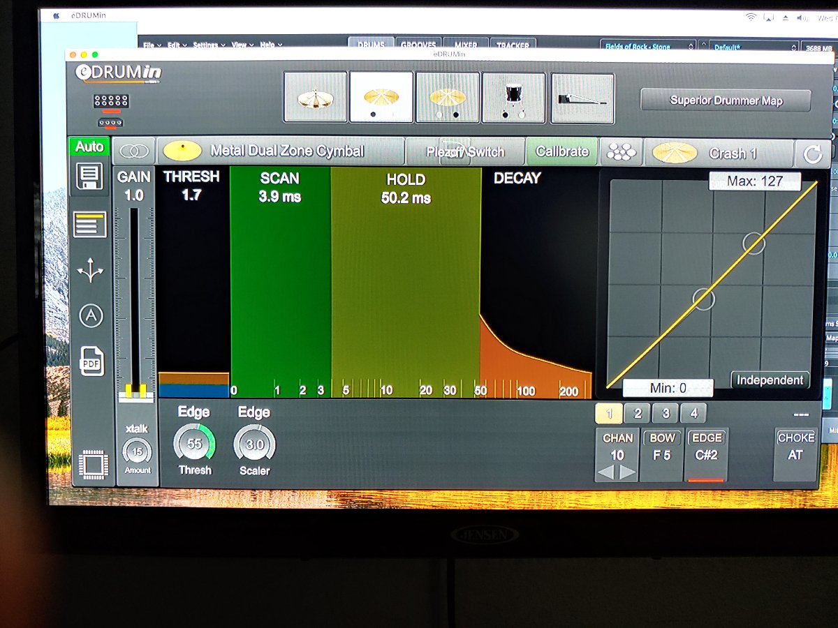

  • Added digital lowpass filter for cymbal type inputs.*
  • Added a velocity indicator to the Velocity Curve control.
*not available on first generation ED4. I designed this control to tame high frequencies on my VH-13, but it would also help out on metal cymbals and other cymbals that lack sufficient dampening. The control indicates the amount of filtering happening. Using the lowpass filter introduces a small amount of latency proportion to the amount of filtering.

Hey Rob. Any chance you could make the gain go below 1? That would help tame
hotter sensors. I assume not since you probably would have done that already.
Posts: 4888
Re: eDRUMin version 2.3 BETA
No chance, however you'll notice that applying the lowpass filter in many cases reduces the effective signal level.

I'm not seeing the control for the low pass filter. Am I missing something?
Posts: 4888
It's stuck behind the piezo / switch button. Opps. Maybe change to another cymbal type, turn it on, and then go back to metal cymbal.
