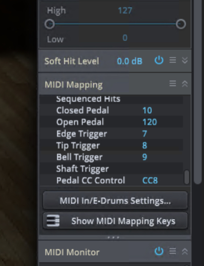

I think the setting you are looking for is in the MIDI Mapping panel for the second hi-hat. Scroll all the way to the bottom and the last mapping is the Pedal CC Control. Also, make sure your pedal is sending the same CC in the eDRUMin pedal settings. See if that gets you going.
I have two hi-hats. One is set to the default CC4 and my second one as you can see is set to CC8.

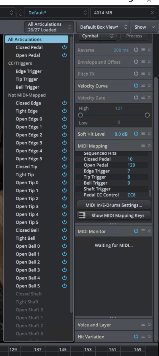

That looks like what I was looking for, would you know the reason articulations for Edge trigger is greyed out? (I'm guessing it's because it does not see an open CC?)
Re: second hihat with ed10 and SD3
Grayed out where? If it is grayed out in the articulation list it could mean there is no sample for the articulation. I don’t think I’ve ever seen it grayed out in the MIDI Mapping list.
This is my setup.
In the eDRUMin the tip, edge, and bell trigger are assigned to the cymbal, the closed pedal, open pedal and CC are assigned to the pedal.
