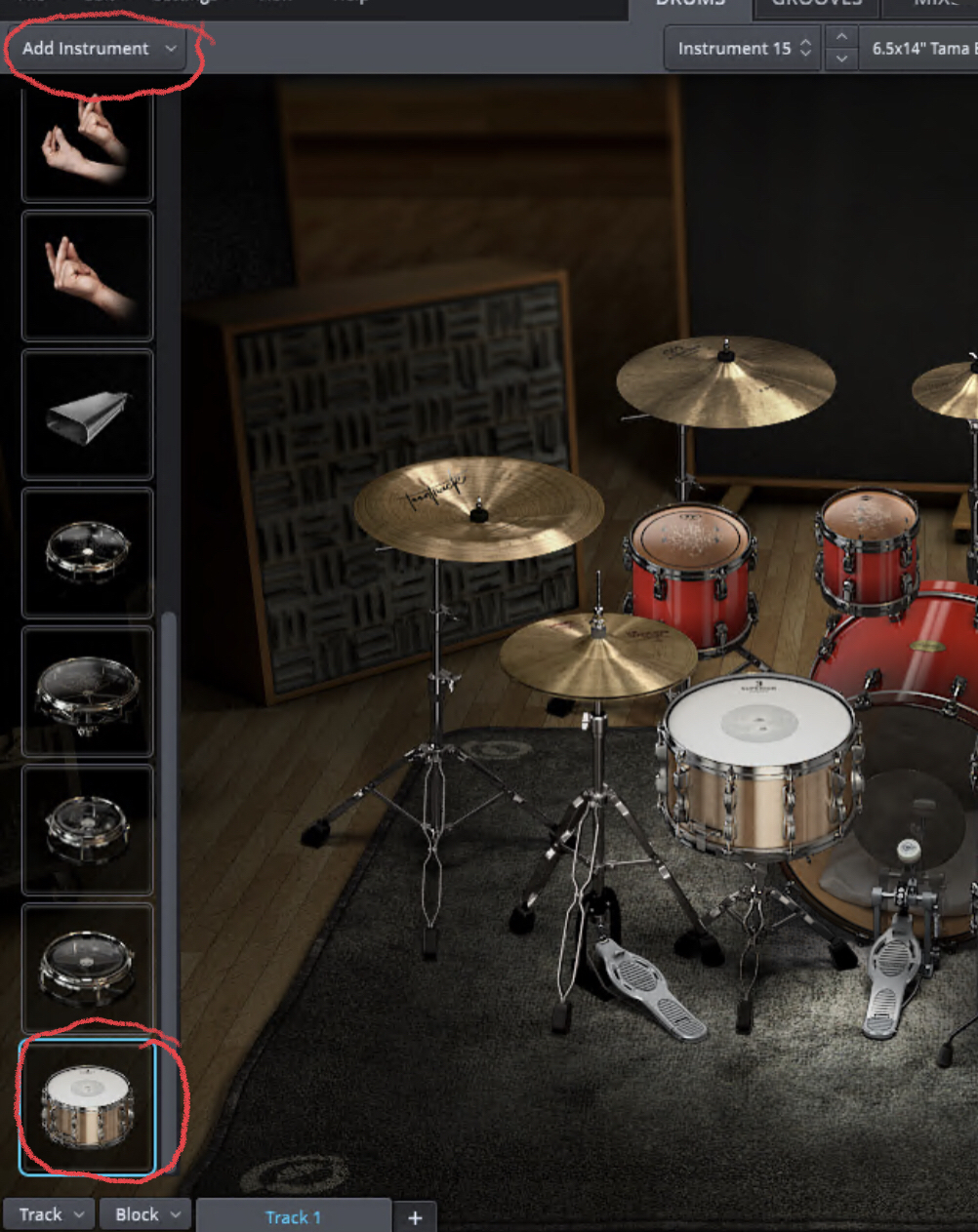

You don’t have to load an entire kit to change your snare. Use the Add Instrument to add a duplicate snare. Since your kit already has a snare it will get added on the left. Set up this additional snare for “snare off” duty with all the proper articulations you want. You may have to change the MIDI notes on this snare as well (but SD3 may have selected different notes for you already). To change the MIDI note select each articulation from the list and edit the assigned MIDI note using the MIDI Mapping panel on the right.
You then take these MIDI notes and assign them to bank 2 in eDRUMin. When you flip the switch presto… snares off.
