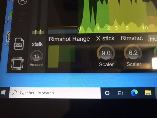

I just did a quick test on my snare and 8” Tom... actually it is there but it is very light gray, all the way as far right as it can be and never really that tall. No matter how hard I hit it never moves left but it will change in size. Is this normal? My rim piezo is attached to the interior of the shell and touching one of the lug bolts.
That is normal. The height represents the strength of the head sensor. I guess it's so light because it's half of the control area and is being antialiased. I can fix that so it draws more opaque.
Rob wrote:That is normal. The height represents the strength of the head sensor.
And never moving off the far right edge? In your video when you hit the rim the indicator jumps around.
I suspect you have a rim sensor mounted on the rim. With that kind of rim sensor, the rim sensor signal is much stronger than the head sensor. So yes, that is normal.

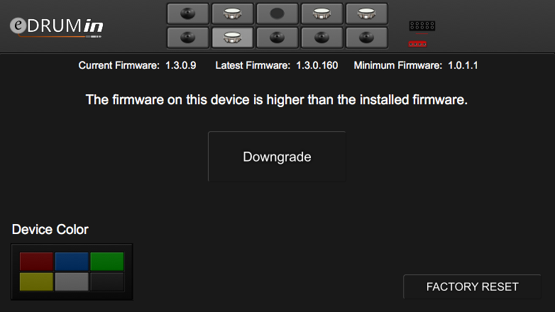

1.3.0.10 beta has issues on the Mac. Installs fine, but shows no "!" next to the Update Firmware icon. Going there yields this screen:
Screen Shot 2020-08-25 at 12.20.50 AM.png (67.75 KiB) Viewed 1338 times
Okay. Thanks. I know what that is. I'll fix it in an hour or so.
I've updated it. I didn't increment the build number however.
That fixed it, thanks.
