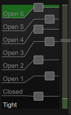

I'm implementing the ability to edit drum maps directly in the preset manager so they don't need to be sent to the device to make changes. Do you think I need to include the hihat transition points in the drum map like is shown in the pic? Probably not right. I'm starting to think that I should have made the number of levels fixed at 8. And for applications that use fewer, the note assignment could just be duplicated. That would make the hihat function properly when switching maps without needing to adjust transition points...not really sure what to do here.
If you have already got what is pictured working then I don’t see a reason to change. However, if that’s not the case then switching to a fixed set of 8 levels I think would work. For current and new HH level users a video explaining how to use 8 levels for a 4 level module is all that is needed. The different module/vst drum maps would need to be updated.

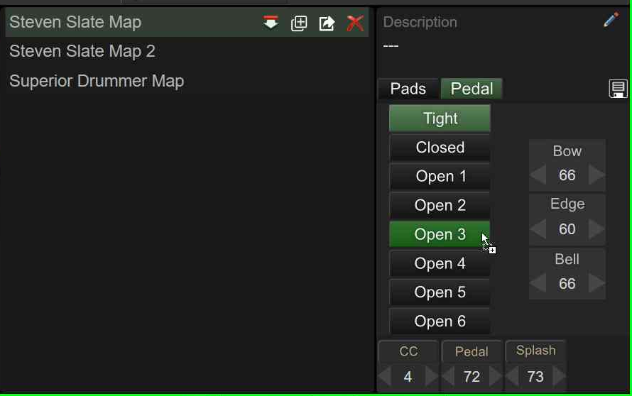

I've decided to go without the transition points, and if the user has the hihat set to use assignments from the drum map, the number of levels will be fixed at 8. Development is a bit slow going because I'm implementing lots of drag and drop functionality. Here's a pic of dragging the Tight hihat level onto Open 3. You can also drag one of those levels onto another preset to update it, or even drag all the 'Pedal' note or 'Pad' note assignments onto another preset.

I've decided to go without the transition points, and if the user has the hihat set to use assignments from the drum map, the number of levels will be fixed at 8. Development is a bit slow going because I'm implementing lots of drag and drop functionality. Here's a pic of dragging the Tight hihat level onto Open 3. You can also drag one of those levels onto another preset to update it, or even drag all the 'Pedal' note or 'Pad' note assignments onto another preset. image.png
Looks good!
