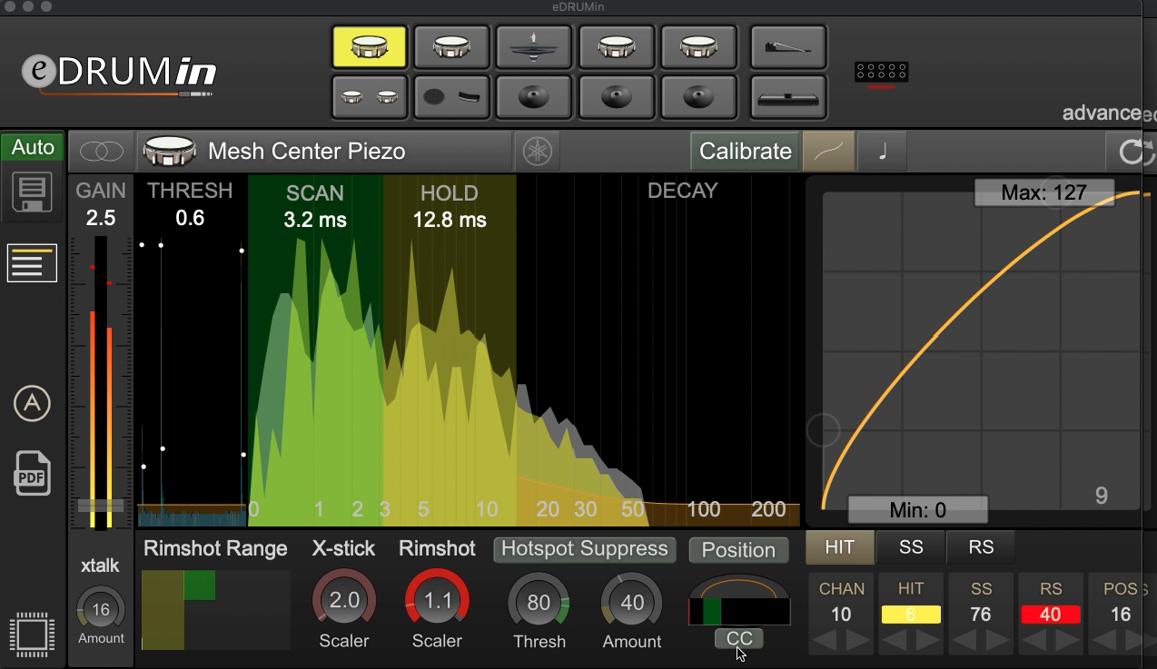

Not sure if related to 1.5 beta or not, but thought I would post here. I've noticed after "fixing" my settings for PD-125BK I'm getting a miss trigger on a rimshot. Here is a screenshot. I didn't know if this is related to a 1.5 change or not. It appears to only be related to a rimshot. If I miss the rimshot and I only get the head, no miss trigger, same thing if I miss it and only get SS, no miss trigger.
double trigger rimshot.png (370.04 KiB) Viewed 1466 times
Posts: 4896
You rw getting a double trigger there. That much is certain. I think you probably just need to relax the decay a tiny bit.
Rob wrote:You rw getting a double trigger there. That much is certain. I think you probably just need to relax the decay a tiny bit.
Yes, a slight bump in the decay fixed it right up.

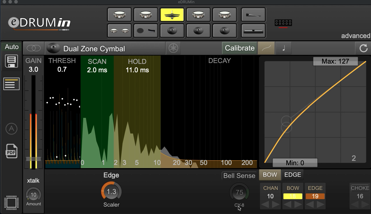

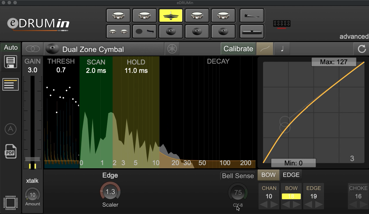

On a related note. I noticed on VH10 that there is a sweet spot (or not so sweet) on the bow, but very close to the edge that there is a double trigger. I was just going to bump up the decay a bit, and fix it like the rimshot. However, I know you wanted feedback on 1.5 beta with changes you made to decay. I first noticed it with my own VH10 settings (which I don't think I changed from factory other than notes and velocity curve). But I loaded the factory preset and took this screenshot so you could reproduce. I was using the tip/shoulder of stick just above the edge and slightly on the bow. Totally may not matter, but I only observed the double trigger with the HH closed.
VH10 Factory present double trigger 1.5 beta pic 2.png (298.05 KiB) Viewed 1427 times
double trigger VH10 factory preset 1.5 beta.png (294.78 KiB) Viewed 1427 times
