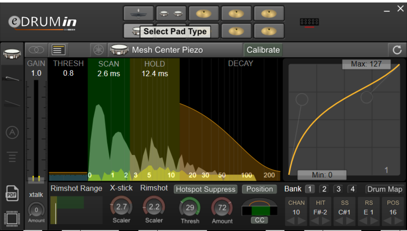

I'm getting quite a few missed hits on this beta. Managed to capture a screenshot of one.
Any reason why this hit didn't trigger (using SD3):
no hit.PNG (318.47 KiB) Viewed 2013 times
Note 'HIT' lit up too.
Re: eDRUMin version 1.3.1 BETA
MWJT42 wrote:Any reason why this hit didn't trigger
Looks like the hit was misinterpreted as being over the hotspot. I think I noticed a hit like this yesterday when I was playing. The hit was near the edge I assume? I'll see if I can make a few adjustments.
