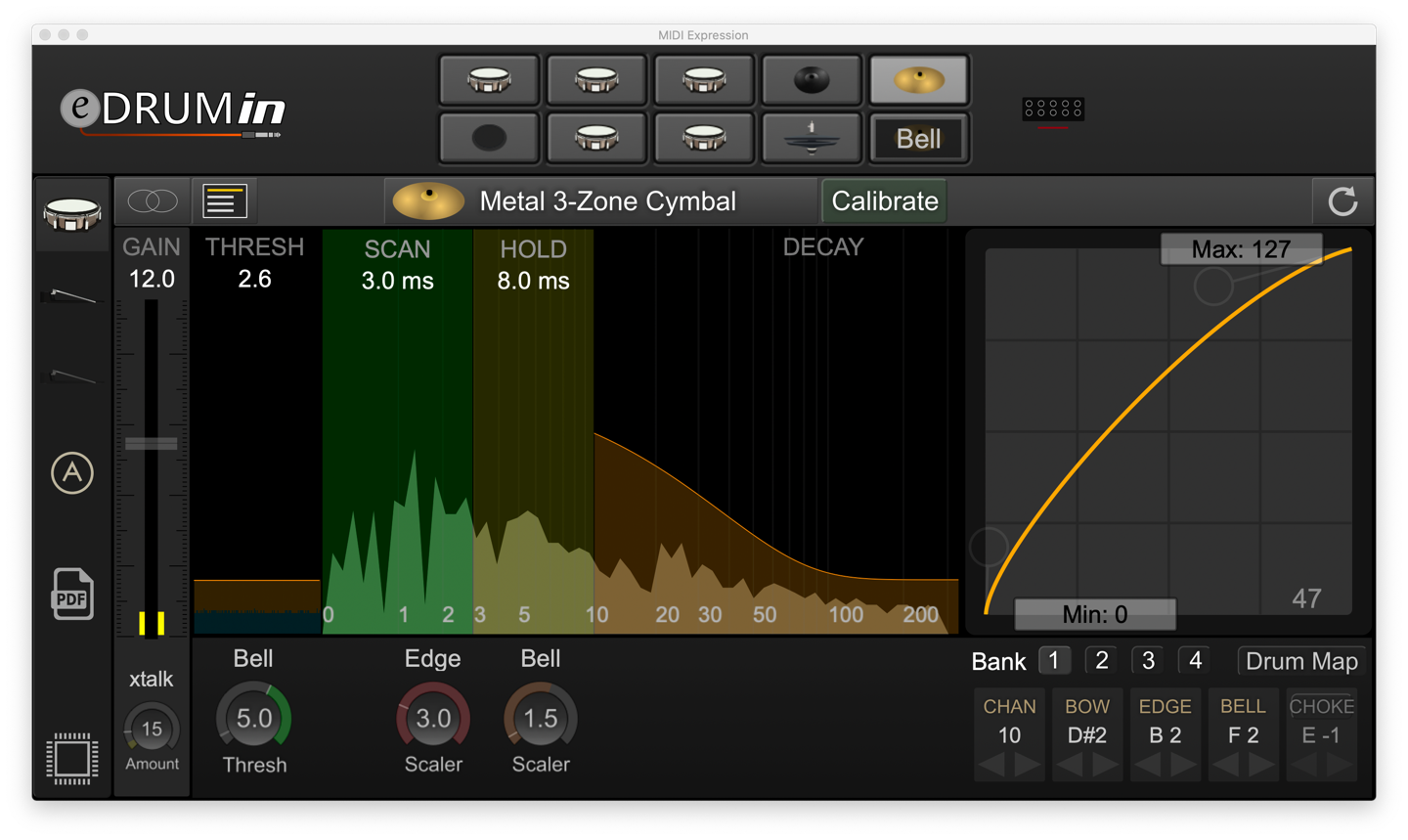

So I have updated but am not getting consistent bell triggers on the ride using the new metal cymbaI three input. I have tried calibrating.
Do you have any advice?

TheJay wrote:So I have updated but am not getting consistent bell triggers on the ride using the new metal cymbaI three input. I have tried calibrating.
Did you use the metal 3 Zone pad type? Did you adjust the bell thresh control?
Re: Zildjian LV converted test
These are my settings, try them, remember to position the cymbal so you don't hit it above the sensor.
Screenshot 2020-09-18 at 08.35.17.png (748.53 KiB) Viewed 1417 times
