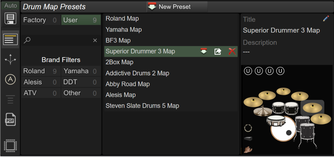

I concur with a graphic that included three rack toms and two floor toms. For cymbals at the minimum: HH, Crash 1, Crash 2, Crash 3, Splash, and China would cover most everything. If I counted correctly that is still less than 20 kit pieces.

I managed to implement sending and receiving drum maps to and from devices today. I think I'm just going to implement it in the preset manager. On the right hand side panel, I'll make it so kit pieces from one preset can be dragged and dropped onto other presets. That should make Hang12 happy. I guess I should change Brand Filters to Application Filters to make it easy to see your 'Superior Drummer' maps, for example.
Btw, those 'U' pads are for user defined. If you want a fifth tom, you can simply use one of those. I can probably allow the image for those to be changed to something more meaningful. I could possibly add more user defined kit pieces, but I'm assuming 20 total kit pieces is probably enough.

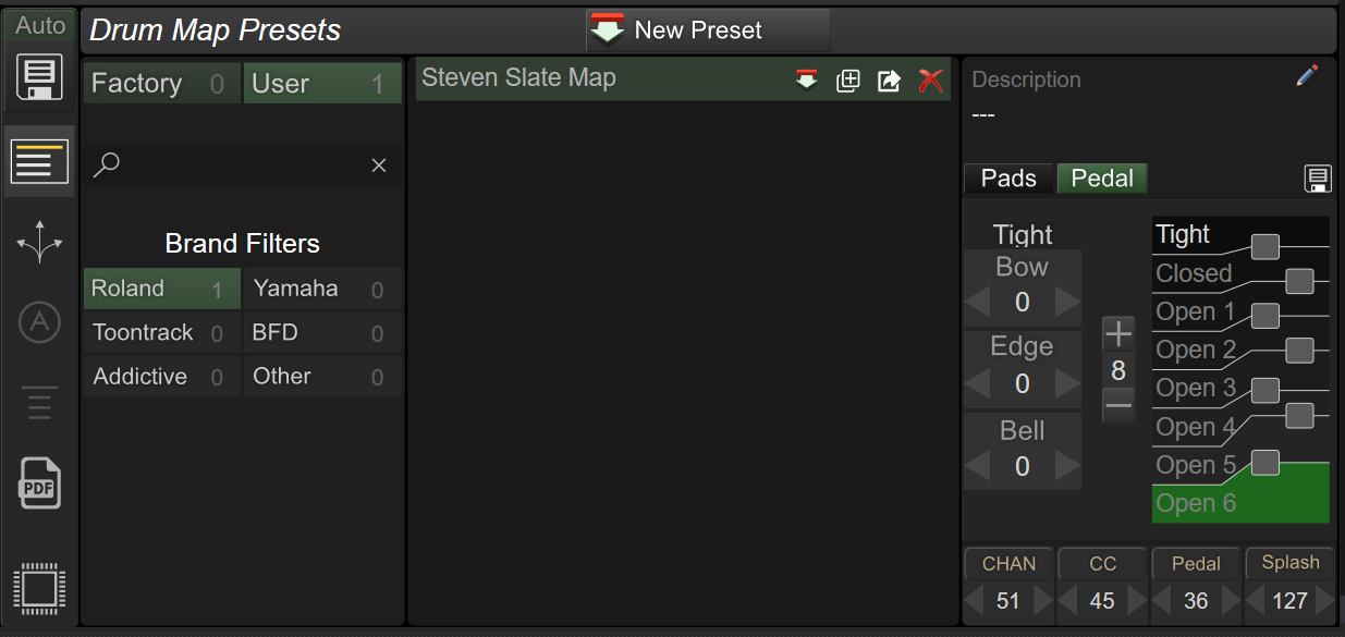

I'm implementing the ability to edit drum maps directly in the preset manager so they don't need to be sent to the device to make changes. Do you think I need to include the hihat transition points in the drum map like is shown in the pic? Probably not right. I'm starting to think that I should have made the number of levels fixed at 8. And for applications that use fewer, the note assignment could just be duplicated. That would make the hihat function properly when switching maps without needing to adjust transition points...not really sure what to do here.
Re: eDRUMin 1.6.2 BETA
Fri Jan 14, 2022 1:52 am
I'm implementing the ability to edit drum maps directly in the preset manager so they don't need to be sent to the device to make changes. Do you think I need to include the hihat transition points in the drum map like is shown in the pic? Probably not right. I'm starting to think that I should have made the number of levels fixed at 8. And for applications that use fewer, the note assignment could just be duplicated. That would make the hihat function properly when switch maps without needing to adjust transition points...not really sure what to do here.
IMHO, adjusting HH transition points is an empirical practice, done hands on while interacting with the device. So, I believe your intuition is correct. You probably don't need to include hihat transition points in the preset manager. Just my two cents.
I'm using CC's, which would seem to be more flexible for cross mapping, as it is determined on the receiving end.
Are you able to copy/paste instruments/pedal presets from one drum map to another, or save and load into a drum map? If so, it might be easier to work outside of this window for this task, then load it into the drum map.
But...honestly I don't really have a grasp on the larger picture yet of how this new functionality is going to work, overall.
