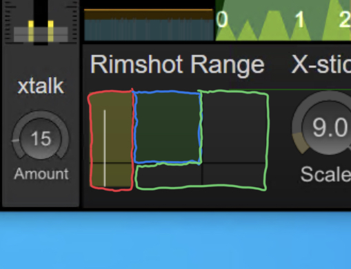

Mylo wrote:I see the sole purpose of this control is to build a rimshot range
AND a sidestick range. Which is not always on the same liner left to right scale. It needs 2 measures to determine when to trigger the Side Stick and Rim Shot.
A left to right 'which sensor is picking it up more' measurement which tells the software when it's not a Snare Head hit (i.e. a white line to the right of the yellow(ish) block)
and then splits this middle area using a 'well how loud was it?' measurement to see if it's a Rim Shot (Green) or Side Stick (Black)
and then there's another 'well that's definitely not a head trigger hit, so it must be a Side Stick, even if it was loud' area to the right of that
So, a left to right control does allow for Snare Head, Rim Shot, and Side Stick areas like you've suggested, BUT, some quieter Side Stick hits are often in the Rim Shot range, so they're set by pulling up the line to allow a black (SS) quieter area under the green (RS).

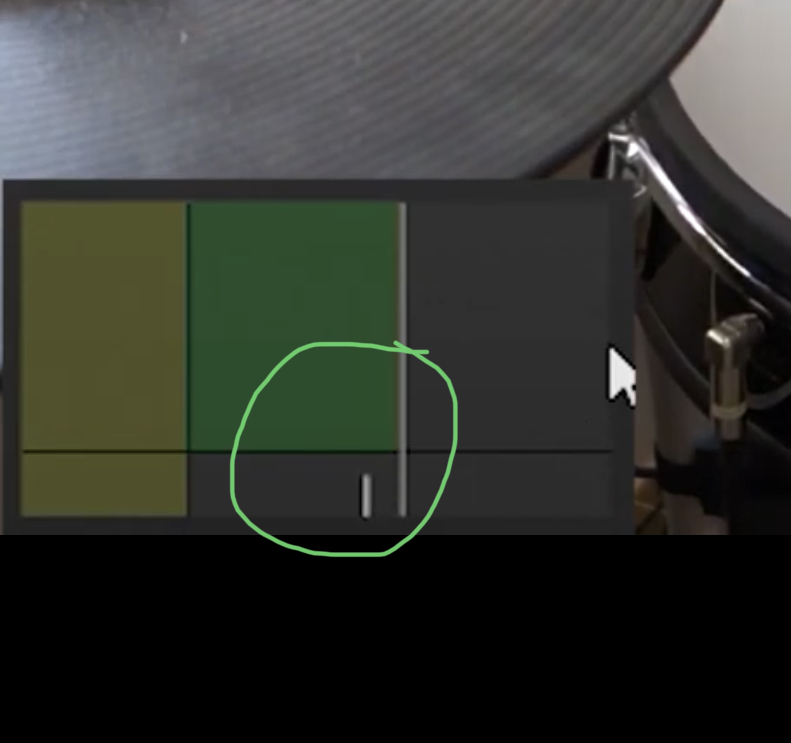

I watched the video for rimshot... nicely done. And it may have generated a little more understanding for me. I may be starting to get this to the point I say don’t change anything.
So the red is head hit. Blue is rim shot and the green is rim. Correct?
So even if I have a rim land in the middle section like the very last hit in the video shows and it is in the lower middle block I’m ok?

Mylo wrote:So the red is head hit. Blue is rim shot and the green is rim. Correct?
Yes. Your diagram is actually really useful - Rob, would it make sense to include something a little more like that in the manual?
Mylo wrote: So even if I have a rim land in the middle section like the very last hit in the video shows and it is in the lower middle block I’m ok?
If by OK you mean a Side Stick, then yes.
Light bulb going off... to understand this control I should have sat down and tried to write the algorithm. Excellent post.
MWJT42 wrote: If by OK you mean a Side Stick, then yes.
Yep. That’s exactly what I meant. Thanks for clarifying it.
