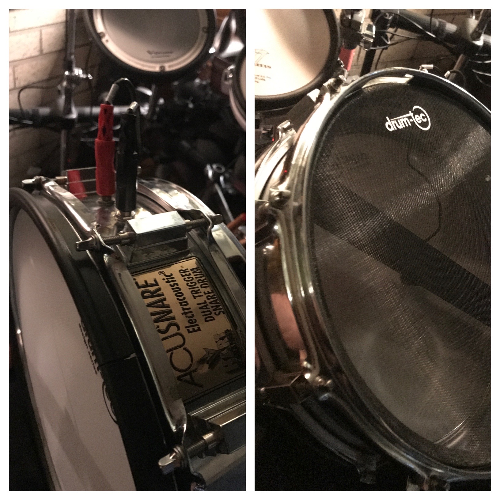

On a whim I bought a Hart AcuSnare. As is, it works! That is, with all the foam padding inside, which makes it loud as fnck, acoustically. I'm going to rip out the insides, but keep the piezos, and install a crossbar. Will report back. So far, so good.

13” Hart Dynamics AcuSnare. I picked one up the other day for cheap, ripped out the foam pillows and installed a (hand cut, wooden) crossbar. Needs a stereo splitter cable to connect/combine head and rim inputs. Installed Drum-Tec 2-ply mesh on top, black single ply on bottom, and Pintech rim silencer. Triggers like a dream: no hot spotting, accurate positional sensing, and fantastic head/rim separation.
I normally wouldn’t have bothered, but the eDrumIn makes it easy to take an “antique” drum like this and get it to work. I’m very pleased with it. It’s a very handsome drum, and the extra 1 inch playing surface makes a surprising difference.
