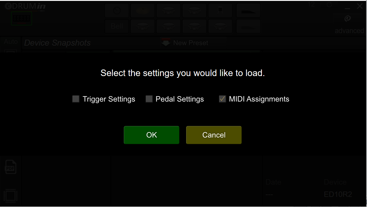

As is, when you load a device preset, you can select to only load the notes, so what you call "file management tasks" really amounts to couple of clicks in the UI.

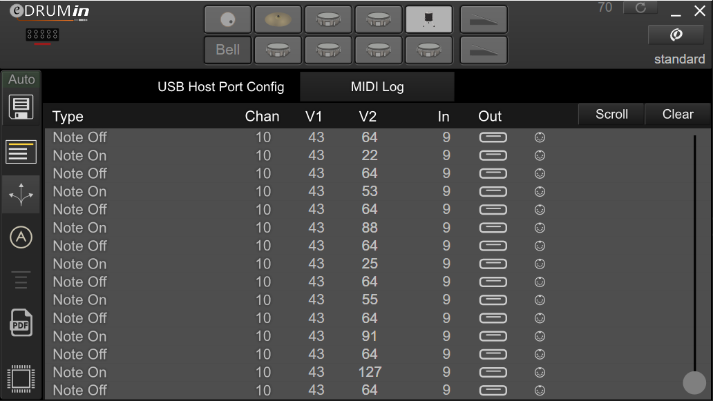

1. Sometimes bell sense does not work reliably until I start the app and click on the ride input button. Also I'm using a Roland cy15 but the cy13 sense settings seem more accurate.
2. The strike indicators on the input buttons and articulations are not always accurate. For example when I strike the ride cymbal, my bass drum lights up unless I click the ride input. When I click the outside area of the my snare with positional sensing. The positional note plays but the articulation doesn't light up, instead it shows as a standard snare strike. It used to show separately and mixed in the green zone

I'll give you a better reply after I've thought about it some more, but I just wanted to make sure you realized that you can already load all the note banks from device snapshot. I'm pretty sure the MIDI Assignments include all the note banks.

... that you can already load all the note banks from device snapshot.
Thanks. The main thrust of my discussion is for being able to quickly copy one note bank to another for editing. There are times when maps work mostly as is, but need to be tailored for say 'less cymbals that have three zones and need to be reassigned to play all three zones to one note (zone)'. and it is a case by case situation. Then there are times that a note map needs to be radically different, and it would be nice to be able to pick that out and load it up from a 'bank note' file, or have it on board already.
I don't see that method of sorting available yet. After quickly reviewing the latest manual, one still needs to create each input note assignment in each note bank by scratch.
