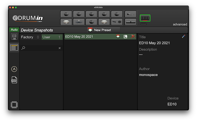

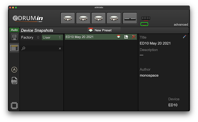

Rob wrote: The list of device presets is automatically filtered by the type of device that's selected (or at least it should be). When an ED10 is selected, you shouldn't see presets for an ED4.
Yeah that's not what's happening. The ED4 snapshot I just tried to save (with a unique name) is not showing up anywhere, and the ED10 snapshot is visible under both devices.
ED4 Selected.png (81.43 KiB) Viewed 1583 times
ED10 Selected.png (83.3 KiB) Viewed 1583 times

I'm seeing some issues in that regard. I'll fix it this morning.

  • Fixed an issue with the Preset Manager when switching between devices.

Device snapshot issue is fixed too (I can now see ED4 snapshots I saved days ago!)
