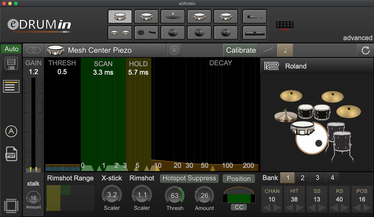

See attached. This is what it looks like after a power cycle.
- Screen Shot 2021-05-17 at 5.36.14 PM.png (156.71 KiB) Viewed 1597 times

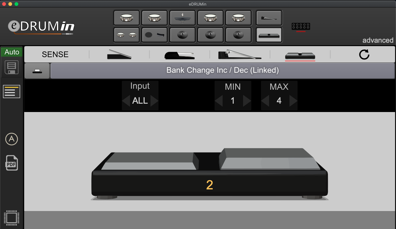

It doesn't look like all of the issues are fixed. What is fixed is on Pedal Input 2 (the footswitch) if last set before a power cycle is 2, when I power cycle it comes back as 2. (see the screenshot).Rob wrote:https://www.audiofront.net/eDRUMin_Cont ... .5.0.6.zip
Changes in build 6
- Fixed an issue with saving pedal input settings.
- Fixed an issue recalling footswitch pedal states.
However, all pads are are on note bank 1. (see the screenshot).
And the HH pedal (Pedal Input 1) is on note bank 4.
Also, changes to HH pedal (S Sense), pedal notes, channels, etc.. do not appear to being autosaved and returned after a power cycle. Also, you'll see in the screen shot the CC position is 123 every time you select the pedal. You have to press the pedal and release it so it will read 0. Also,When you change the note bank 123 pops up again even though pedal is open.
Finally, I did this test again, but cycled Auto Save from ON to OFF and back to ON. When I do that....it all works
- Pad after power up.png (292.7 KiB) Viewed 1540 times
- Pedal Input 1 after power up.png (252.38 KiB) Viewed 1540 times
- Pedal Input 2 after power cycle.png (158.06 KiB) Viewed 1540 times
