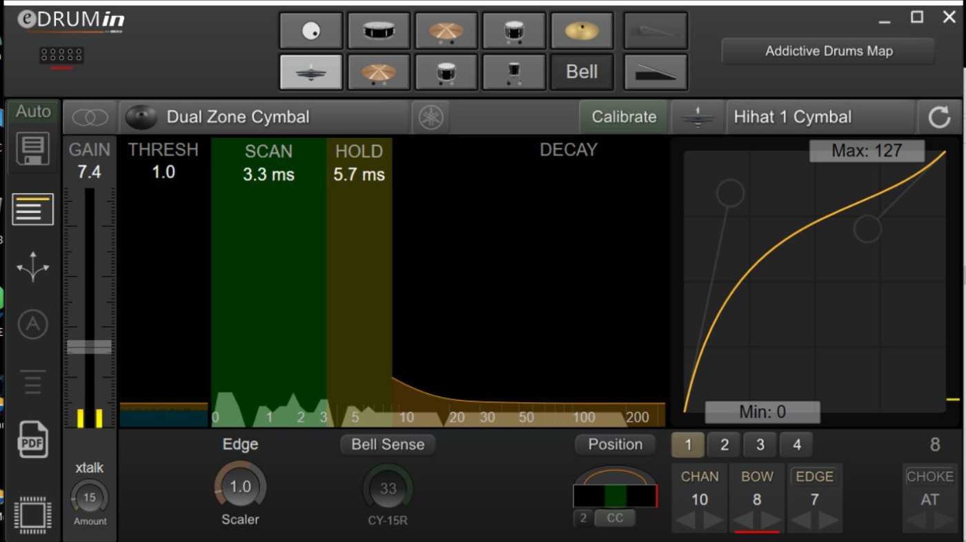

Somehow I lost he "Stand" in build 13, any help where to search for it? Am I doing something wrong?
Thanks in advance!
Thanks in advance!
- hihat.JPG (94.61 KiB) Viewed 34022 times
