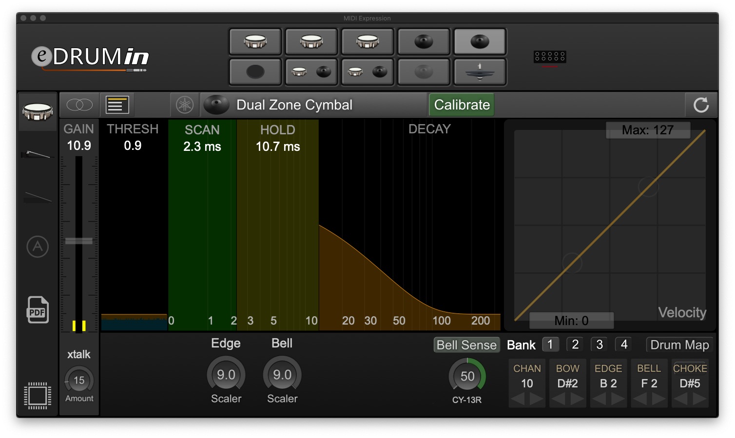

I managed to get the atv 14" to trigger very well as ride with bell sense with the following settings
atv 14.jpg (190.41 KiB) Viewed 7136 times
