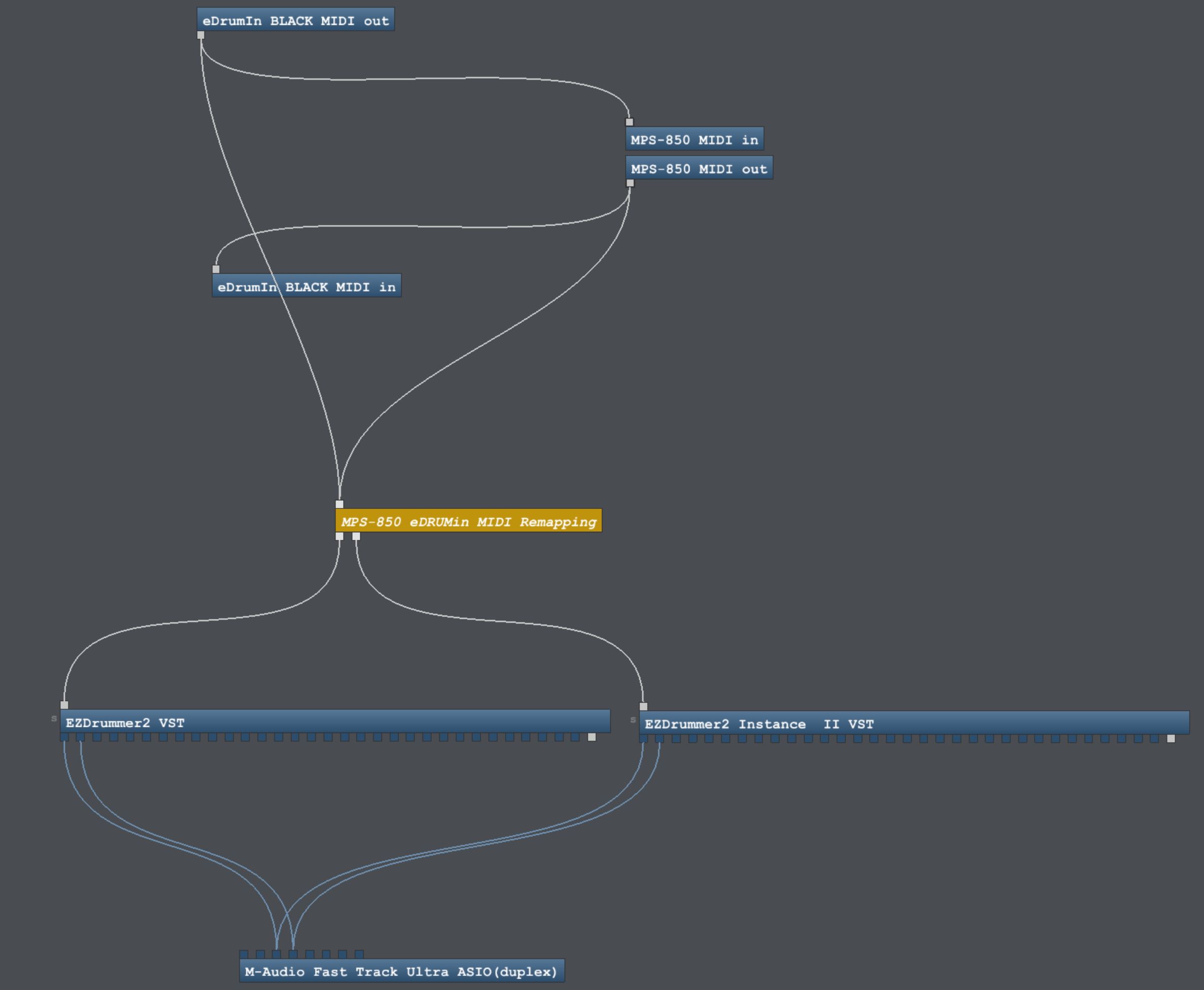

mprinz
Posts: 403
Re: Those of you using more than 1 edrumin module, how are you finding it?
Post by mprinz »
Hi dudes,
with regard to that:
Polyphonics wrote:
Can anyone confirm how edrumin deals with crosstalk from other modules and vice versa????
You got some informations?
I am using a dumb Millenuim MPS-850 with one eDRUMin.
As I have seen and unterstood the concept of elemination of x-talk,
I contected some more MIDI inputs in the Plogue Bidule software and tadaaaaaa
I saw those yellow signals in the transient window.
The eDRUMin notices the hits to the MPS-pads so on the als eDrumin connected pads I have no x-talk issues.
Nothing.
I mounted a 2nd HiHat CY-5 pad between the 3rd and 4th tom of the MPS and connected it all to he MPS module.
And it's triggering the tom when I hit the cy-5. I tried a few settings, but maybe
I will connect the 2nd hats to the eDRUMin, then there will be silence.
Bidule MPS50 eDRUMin MIDI routing
Greetings
