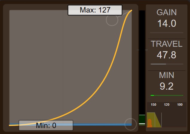

I think I've managed to improve hihat position stability significantly. I'm linking to development build with a new set of controls. There are actually 3 controls, but perhaps I can omit some based on your feedback.
http://www.audiofront.net/eDRUMin_Contr ... 1.0.27.zip
Using the new controls should be straight forward. When you hit the hihat, the change in the hihat position as a result of the impact is displayed in red. As long as the red is covered by the yellow area, it will not produce a real change in the hihat's position. Be careful about dragging the yellow area out too far as this can prevent the hihat pedal from working as intended. Let me know what values work best with your setup (the three numhers at the top of the control). Also, make sure that the HH_Xtalk control is enabled on the input you use as your hihat.

I will give you Feedback in a few Hours. Will try it with a VH10 and ATV 12" HiHat.
Is that example your Settings with a VH10?
Re: Hi Hat Artifacts: Possible Improvement?
Yes. Those are the defaults by the way, and the defaults will be restored every time the eDRUMin is plugged in. My hihat stand is pretty crappy though and lacks a tensioning system I've ordered a better one so I can do more testing.
