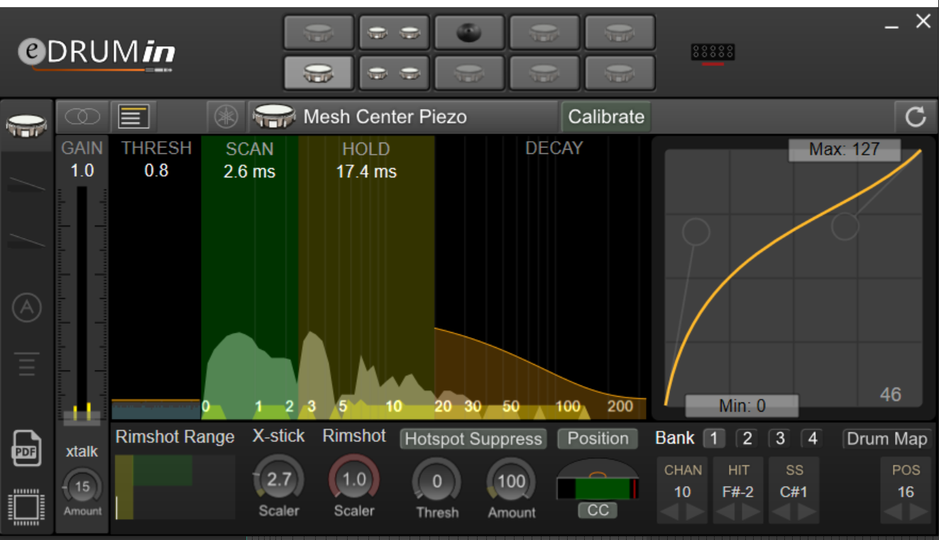

Couple of issues mesh centre trigger:
Rim Shot note has disappeared (from under the curve)
And Hot Spot Suppress is completely dead! Not functioning at all for me, nothing registering on the threshold meter (was perfect in previous build)

Screenshot please.
Rob wrote:Screenshot please.
Thanks Rob

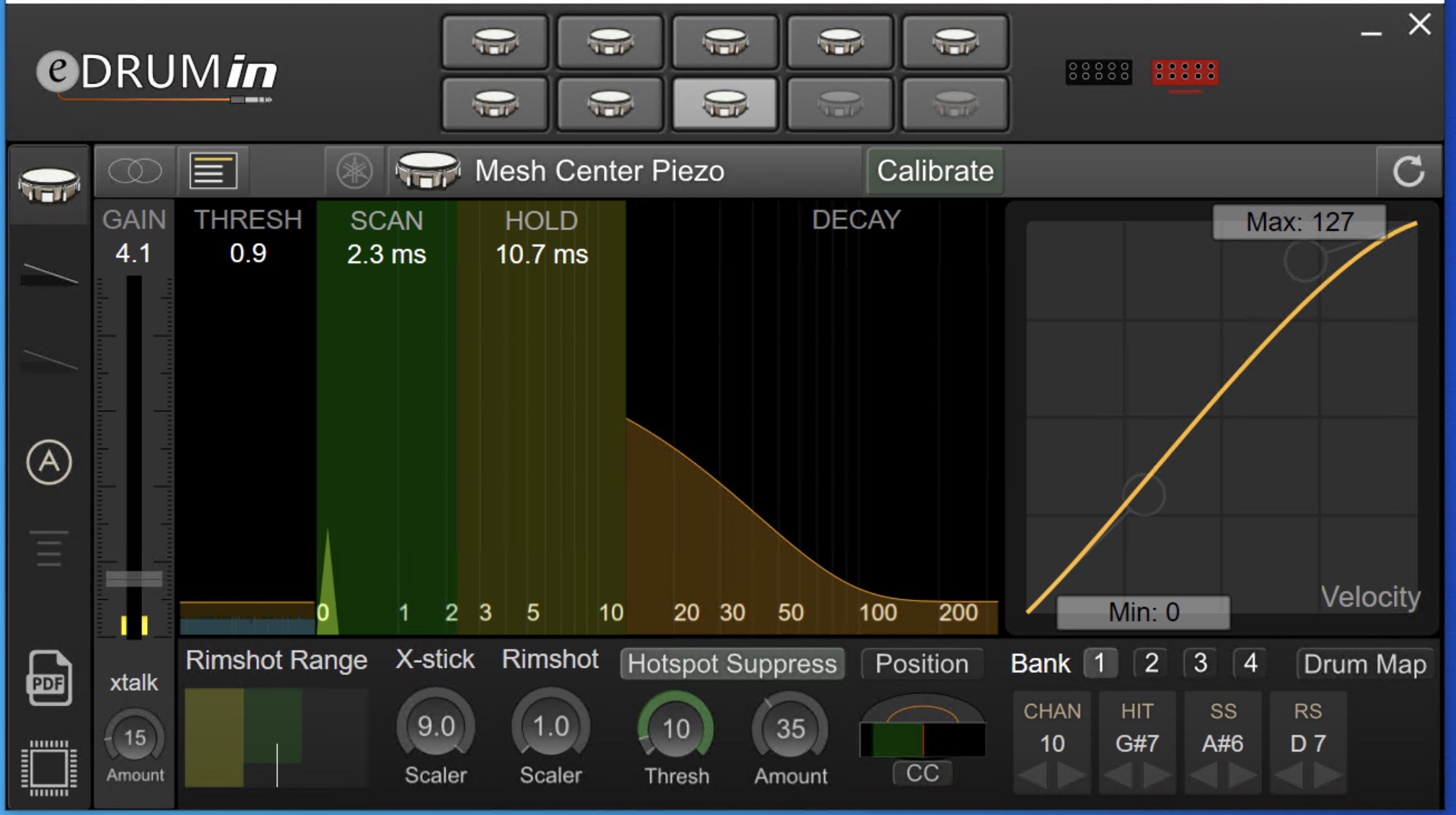

Restoring presets is not working. I reported this some time back but I don’t think you saw it. All my presets were saved and restored with the version 28. I’m not sure if the problem is in the saving or the loading.
Here are my original settings for the drum:

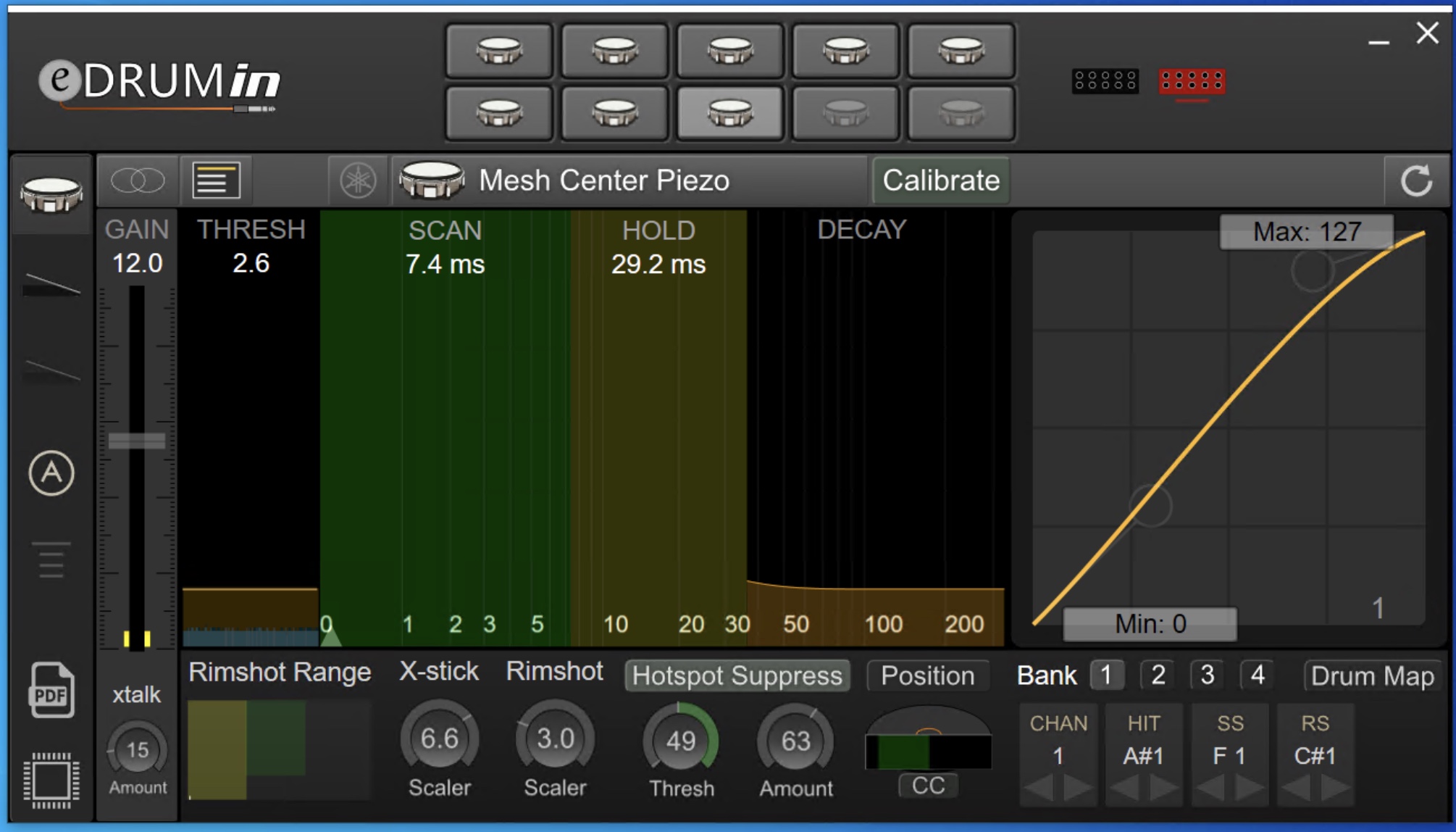

I then changed all the settings:

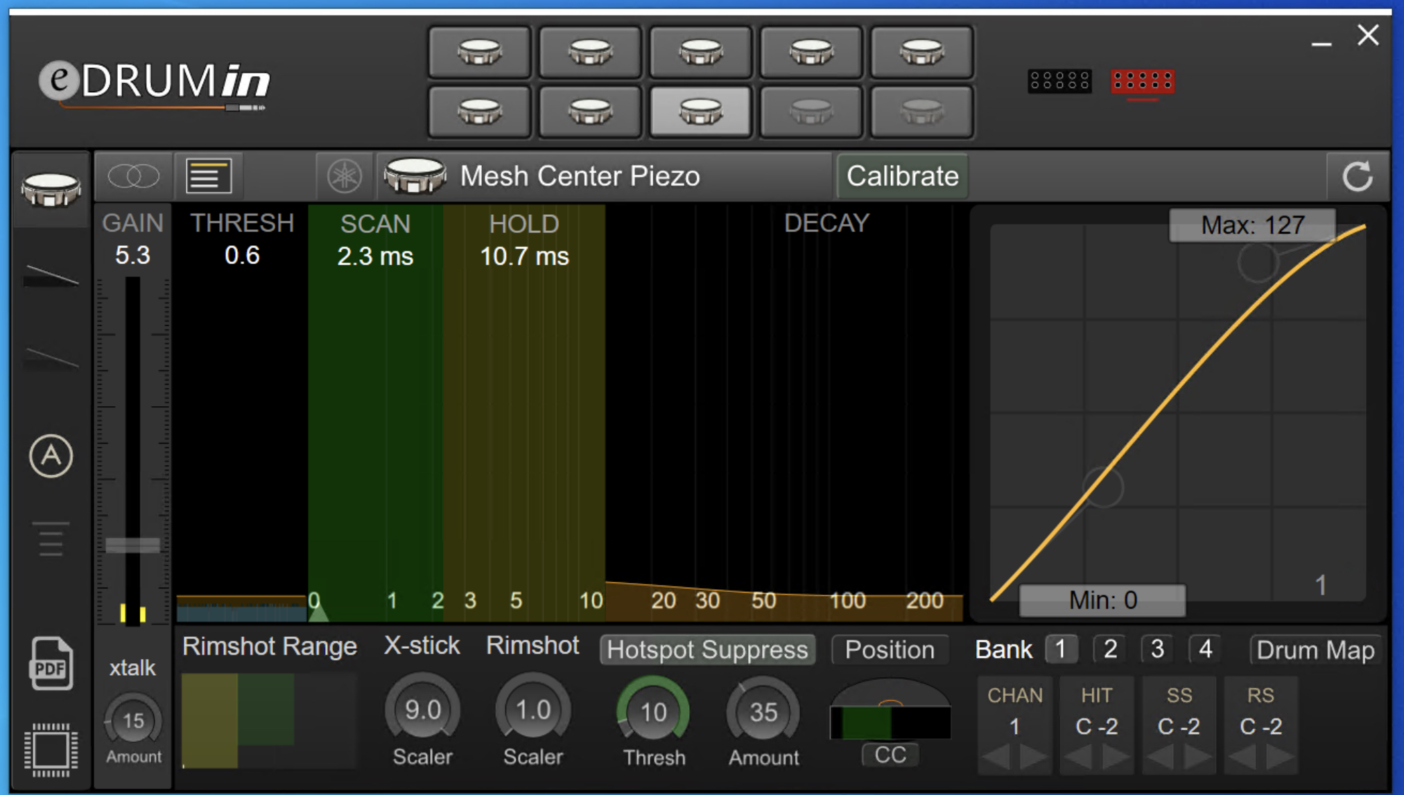

And after loading my user preset back to the same drum:
Looks like all the notes go to zero, channel is set to 1, and the gain and threshold aren’t quite right. I think everything else restored fine.

MWJT42 wrote:Couple of issues mesh centre trigger:
Can you save that input as a user preset, export it, and then attach it to this thread? I want to see what's causing that because I'll unable to reproduce that here.

Mylo wrote:Looks like all the notes go to zero, channel is set to 1, and the gain and threshold aren’t quite right. I think everything else restored fine
It thinks the preset was saved from an ED4, so it's compensating the thresh and gain (not sure about the note bank issue). It's of course not correct. Can you check if saving and loading a preset on your black device is also causing issues?

As noted... these presets were saved with the ED10 using v28 just a couple of days ago. They were edited a couple of times because I’d change a name or a description, I’m not sure if that has anything to do with it.
Ok that is just bizarre. I really did create those user presets two days ago. The other device failed as well. But I went to each pad and overwrote each preset using that download looking button. Now they are all restoring just fine. I thought maybe it was just on a create user preset so I deleted my snare preset and created it again. It too restored just fine.
So I guess nothing to see here now.
