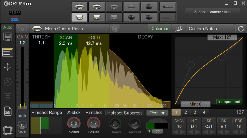

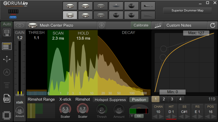

I found a strange behavior on my snare. When I change the hold time and save the value (doesn´t matter if auto/manually) then the hold time jumps to a different value when I trigger a Rimshot. Same behavior when I click on RS or SS. I thought the scan settings are set for all articulations.
I use 2.0.1.6 (windows) but same on 2.0.1.5. I hadn't observed this with 1.6.2.6.

klatho wrote:
Wed Aug 03, 2022 8:21 pm
This is because of the way that hold time is calculated and the limited amount of resolution that the control has. The result is that small changes might not cause a real change in the value. I should be able to better reflect this is the UI. I'll take a look at it today.
Update: The hold time is stored as an integer, so any changes less than 1ms won't update the stored value, and then due to rounding what looks a change of 1ms (like in your case), might actually be slightly less. Fixing this properly would improve the resolution to about 0.4ms, but would involve a significant amount of work and the potential for bugs that might follow from it.

Re: eDRUMin version 2 BETA
This is handled properly version 2.0.2. The control now has a resolution of 0.4 ms. This will not provide for an better triggering, but UI values will stick properly.
