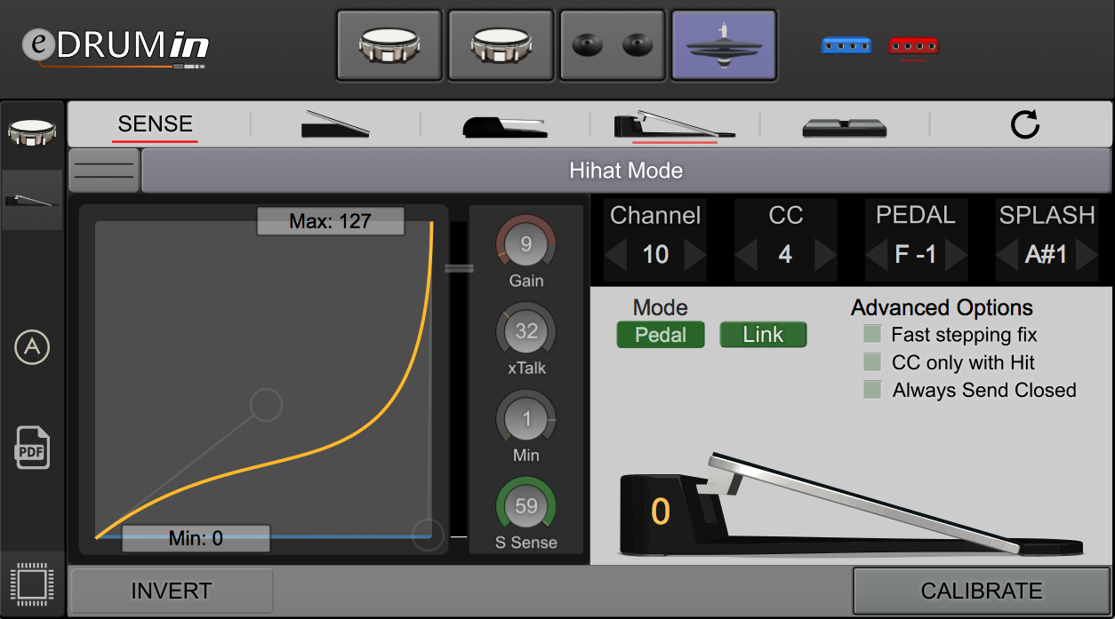

Version 25 allows me to Hihat_slpash !!! :) Thank you Rob!
I was plannung to get a hihat with adjustable Spring before 25.
Wouild you still get another "faster" Hihat Machine ?
Regards,
Peter
HiHat Working Splash 1-3-0-25 07_09_2020 .png (256.38 KiB) Viewed 1523 times
