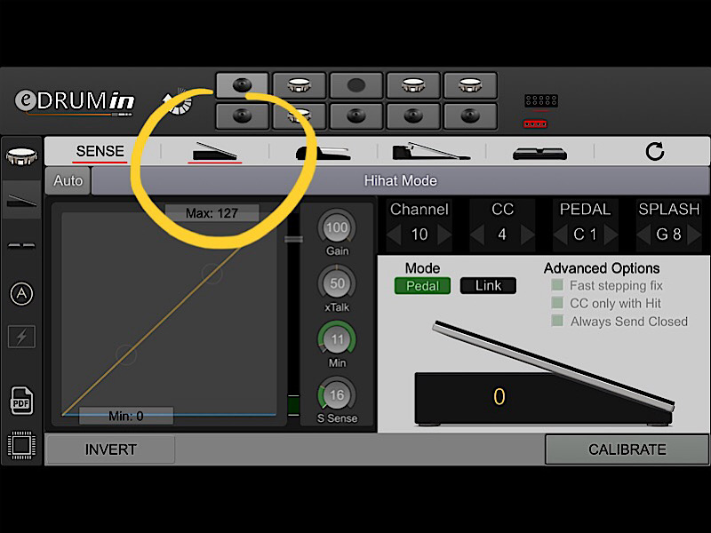

After powercycling from the last crash, my hihat pedal input had reset (see screenshot). Selecting pedal style #3 restored everything to where it was.
No other issues as far as I can tell.
