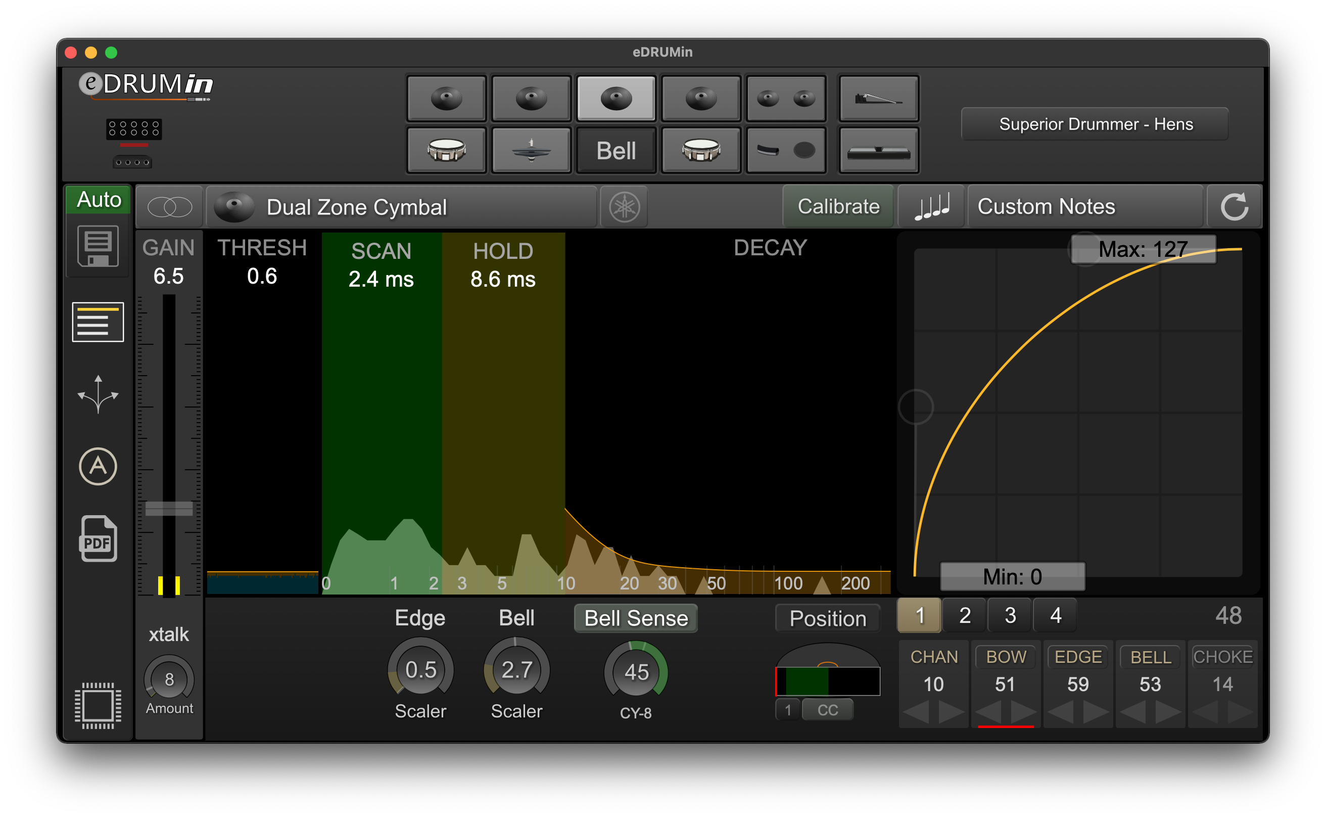

In my case, I have the cymbal itself on input 5, and the bell on 6, below it. Not sure that it matters much. I’ve already tried multiple variations on what you’re suggesting, to no avail. I can get any old input/trigger combination to work on input 5, but input 6 is stuck on “Bell”, and can’t be changed.

Screenshot and device snapshot attached. Build is 2.0.1.6

I had issues loading your device preset--perhaps another bug. Can you select the Bell input and post another screenshot so I can see the settings for that input.
Re: eDRUMin version 2 BETA
I reviewed all the code related to resetting an input and made a small change that might fix your issue. Can you checkout build 7? Change input 5 to 3-Zone Roland Cymbal, and then reset input 5 or change it back to 2-Zone and see if that frees up your input 6. You'll need to apply the firmware update as well.

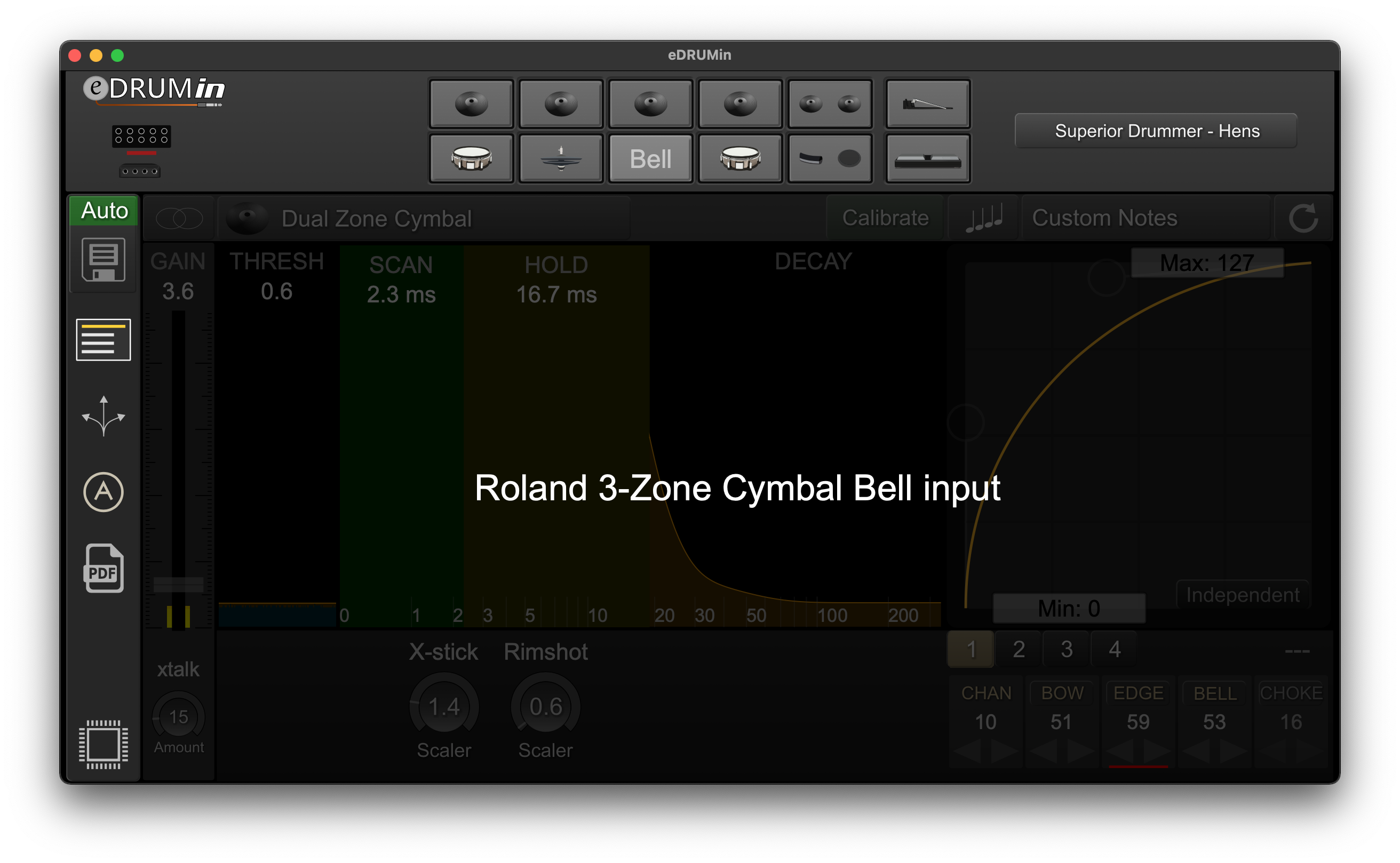

eDRUMin_Control_OSX_2.0.1.7.zip
This made no difference.
Attached is a screenshot of input 6, after selecting a Dual Zone Cymbal for input 5.
