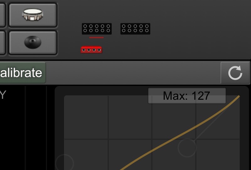

1. I'm getting random bouts of non-responsiveness with the app open and playing the drums. No signal appears to be coming in, and no MIDI is being sent out. The app is not locking up though, I can still switch inputs on the screen just fine. Powercycling the trigger module restores functionality, but often the screen still displays the "Plug-in your eDrumIn" message, until I physically plug/unplug the device. Possibly related: on one of these occasions, the top right of the display indicated I have two ED10s (next to each other) with an ED4 connected to the first one. In reality I have just one ED10 with an ED4 connected. 2. The rotary controls don't update their numerical values in real time. When I change a value, I have to tap the control again, or wait a couple of seconds before the numbers update.

Yes, please post bugs for the iOS app here. I've been trying to do a throughout bug killing section, but every time I start, I find an issue that takes 3 hours to locate and fix
Are you using build 22?monospace wrote:I'm getting random bouts of non-responsiveness with the app open and playing the drums. No signal appears to be coming in, and no MIDI is being sent out. The app is not locking up though, I can still switch inputs on the screen just fine.
Thank-you. I'll investigate.monospace wrote:2. The rotary controls don't update their numerical values in real time. When I change a value, I have to tap the control again, or wait a couple of seconds before the numbers update.
