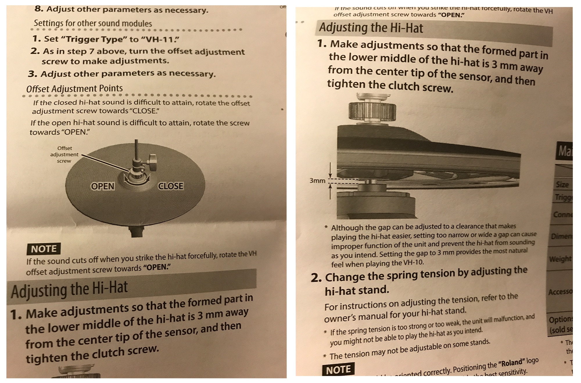

Rob wrote: Those markings are misleading. Adjusting that knob affects the maximum distance that plunger can be pressed. If you turn it too far in the counterclockwise direction, the plunger will bottom out early. You can actually hear the higher pitched tone as the plunger reaches the end of its travel. What you want instead is the bottom of the cymbal to 'impact' the top to the controller before the plunger reaches the end of it's travel, which results in more of a thud tone.
By setting this properly, you will get varying degrees of 'closed' depending on how much pressure you use. It's also important if you want to be able to use the 'impact' method of detecting the hihat 'chck' articulation.
I think you're talking about the "tight" articulation. I've never had a problem achieving that by following the instructions from the manual (pictures below, I happened to still have it laying around.) I tend to leave the knob somewhere in the middle, for maximum flexibility, and it's definitely easier to get the "tight" sound when turning it CCW, and more sloppy when going CW. I've calibrated the eDrumIn to work with it according to the manual suggestion (actually more like 6mm clearance instead of 3mm) and it works great. In fact I think leaving a little bit of a gap makes achieving a fully open sound a little easier.
vh-10 copy.jpg (731.22 KiB) Viewed 1426 times
Those instructions are for a Roland module. The reason why it's important to not have a gap is because it's helpful for the eDRUMin to know when the cymbal is moving. If there's a gap, the cymbal starts moving before the position of the pedals start changing.
I've updated the that 'Setting up your hihat' document to make it more clear. Maybe give it another read.
