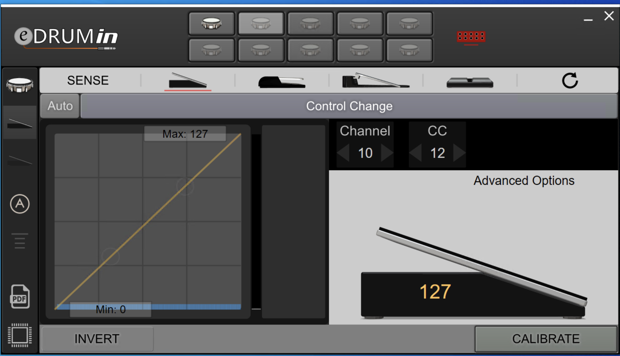

In the controller app on the Pedal Editor the Advanced Option label appears in places where there are no advanced options.
Thank-you. Fixed for the next build.

Rob wrote:Thank-you. Fixed for the next build.
Sorry... I should have noted that the image was just one example. The label was in several places. If that matters.
Thank-you. I fixed the the manual issues too. I quickly had a look at the firmware code for the bank changes, and noticed that I didn't have any error checking in there. Currently if you send your message on channel 11, for example, the device will try to comply and ultimately produce some undefined behavior. I fixed that as well.
