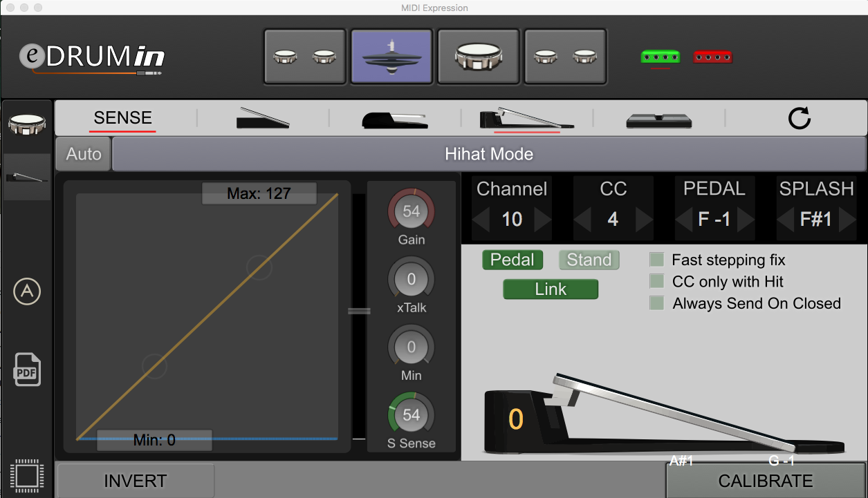

I am currently Using MODO drum.
I attached a screen shot of the Pedal editor with the settings that works for me
with 1.3 buld 14
Peter
working with build 14 but not 15, 16, 20
screen shot pedal editor for hihat .png (259.94 KiB) Viewed 1353 times

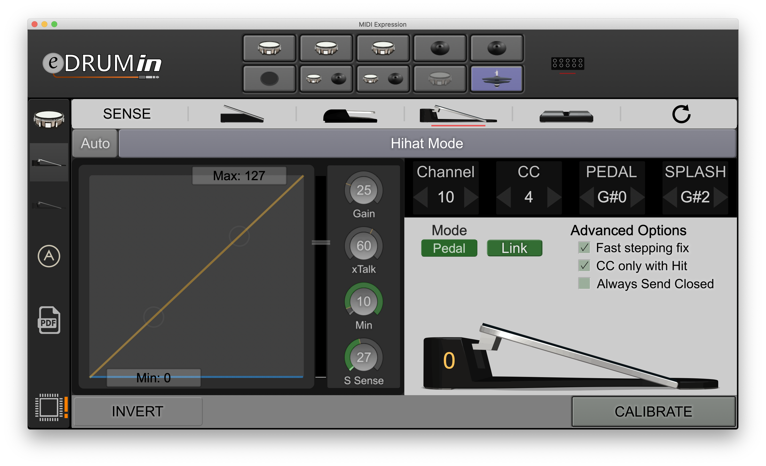

You can download modo drum demo and it will work in full mode for 10 days! I just downloaded it and set up the hihat and it triggers splashes and chicks perfectly, attached the hihat mapping,
Screenshot 2020-09-04 at 10.50.03.png (1.51 MiB) Viewed 1335 times
My edrumin controller looks like this:
Screenshot 2020-09-04 at 10.52.10.png (1.84 MiB) Viewed 1335 times
