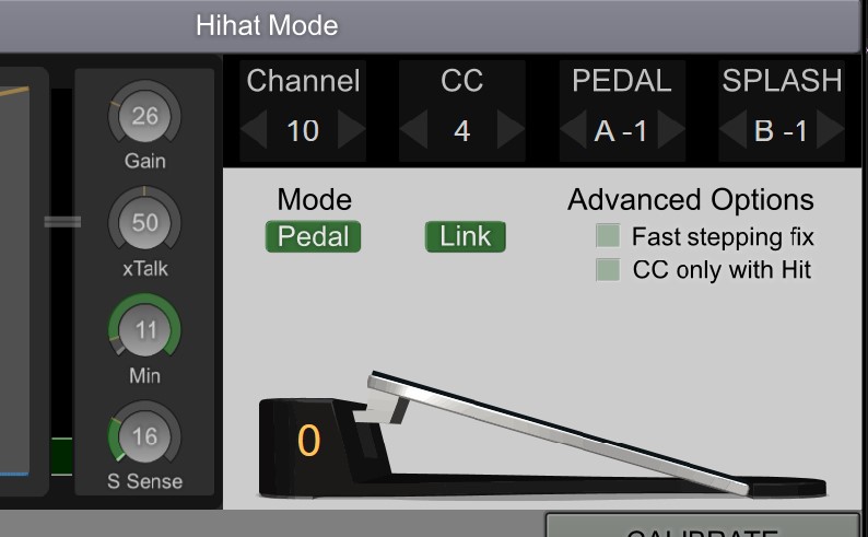

monospace wrote: Didn't know that. Do you know if that can be disabled, and how, so I can compare side by side?
That's what the 'fast stepping fix' does.
Mylo wrote:Now when I do a splash I see a pedal (8 for me) and a splash note in SD3. That feels half way right but I’d rather just see the splash note and let SD3 do its thing.
Well, that's just not how things are done. You first send the sound of the cymbals coming together (chck sound), and then if the cymbals open up again quickly enough, you send the splash. But you are definitely starting to see why it's important to send out the splash as quickly as possible, and that's what I'm trying to do with the last few builds.

MWJT42 wrote:Rob, any further thoughts on renaming 'pedal' / 'stand' - as my GHC (and the VH11) is definitely on the stand!
I can get onboard with some label changes too. I have VH-11 sitting on a real hi-hat stand too. I use “Pedal” because it works best for me and I’m not using a bottom hi-hat cymbal.
I know the how these are defined because I read the docs and followed along with the development. But if I was a newbie I would assume Pedal is a pedal only with no stand like an Alesis Nitro Kit. Where Stand is an actual hi-hat stand whether you have a bottom cymbal or not.
A VH-11 on a stand with a single cymbal screams at me to pick Stand even though Pedal is the preferred choice.
Unfortunately I can’t offer any better solution at the moment. I’m thinking hard on it though.

Maybe Pedal / Cymbals. After reading the docs the hi hat type is defining what triggers the articulations. It’s either the pedal or the cymbals.
Pedal / impact?
Rob wrote:Pedal / impact?
Definitely better. Maybe these buttons need a label. I know you mentioned a UI fix up that is coming but for now...
Trig Method
Pedal / Impact
People might start what wondering... impact of what?
Label suggestions:
Trig Method
Trig Device
Trig Type
Button label suggestions:
Pedal / Impact
Pedal / Cymbals
Does anyone use / want the 'always send on closed' feature? If I got rid of that, I could declutter things a lot.
