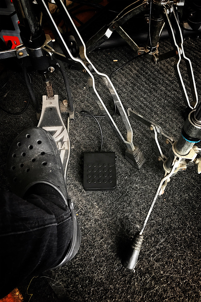

Re: Pedal recommendation?
My decidedly crappy Casio sustain pedal now works beautifully. I’ve set it up next to the hihat to trigger stick count-ins.
Yes I play with Crocs. Don’t judge; these are difficult times.
