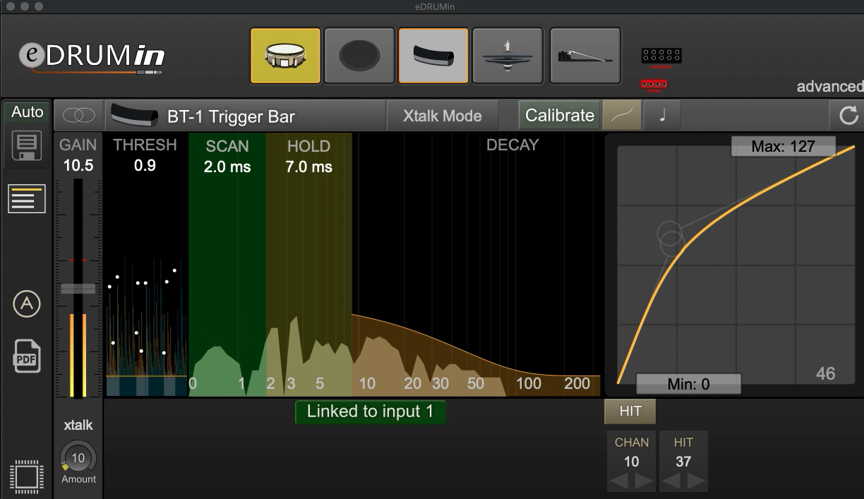

Very minor, but I took a screenshot of something I saw. I was playing 16th notes on my snare rim for rim click, and I noticed at times (with auto select on) the eDRUMin pad would flip to BT-1, even though the side stick was not played. So I took a video and captured a screenshot. Looks like when there is some crosstalk and the BT-1 picks it up, the cross talk is appropriate cancelled by the linked to input 1 feature, but auto select will still go to the BT1 pad. Very very minor, but thought you would want to see the screen shot.
edit: you'll see in the image the BT1 pad is shown selected in gray, but doesn't show yellow or other color to indicate a note was triggered. The snare pad continues to be the only pad that the color indicates a note, like yellow or red.
BT1 auto select error
BT1 autoselect error.png (261.35 KiB) Viewed 1639 times
Posts: 4899
That makes sense. Definitely a bug. Thanks.
