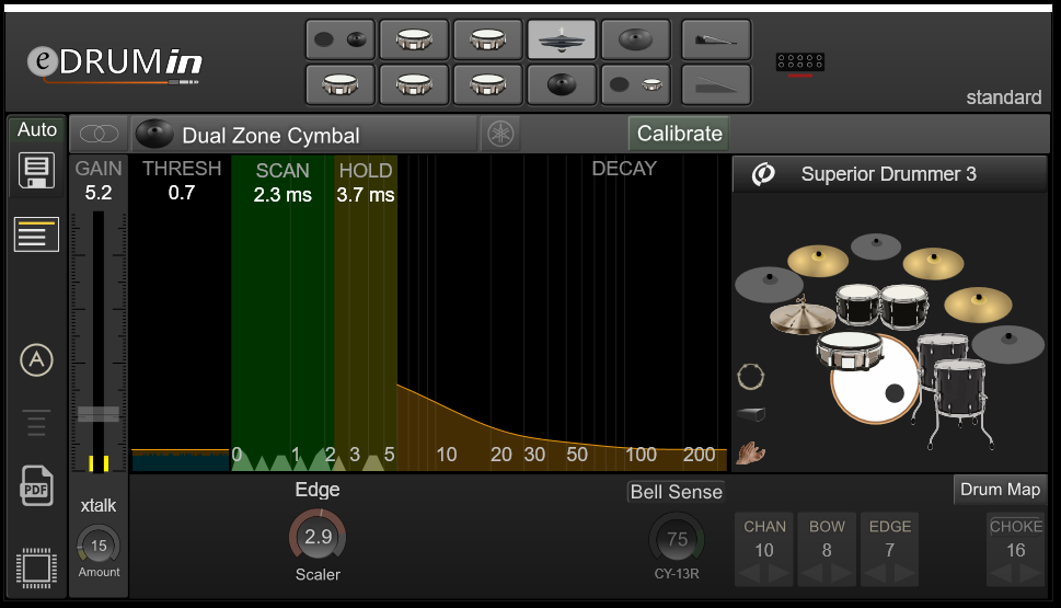

Cannot change the MIDI note assignment for the VH13 Hi Hat on E10 Build 1.15.0.19, Firmware 1.15.0.16 input 7.
All other inputs work.
Power cycled E10 and restarted computer. No change.
The MIDI note assignments are grayed out.
If control input 1 is unlinked then the MIDI notes can be changed. Relinking produces the same problem.
Relinking sometime will not allow the channel to be selected, sometimes it does.
Linking the control to another input will produce the same issue.
See uploaded screen shot.
Posts: 4899
You can't change them when you are using hihat levels mode because the notes are controlled by the hihat of course.

Thank you for the insight. I see it now.
