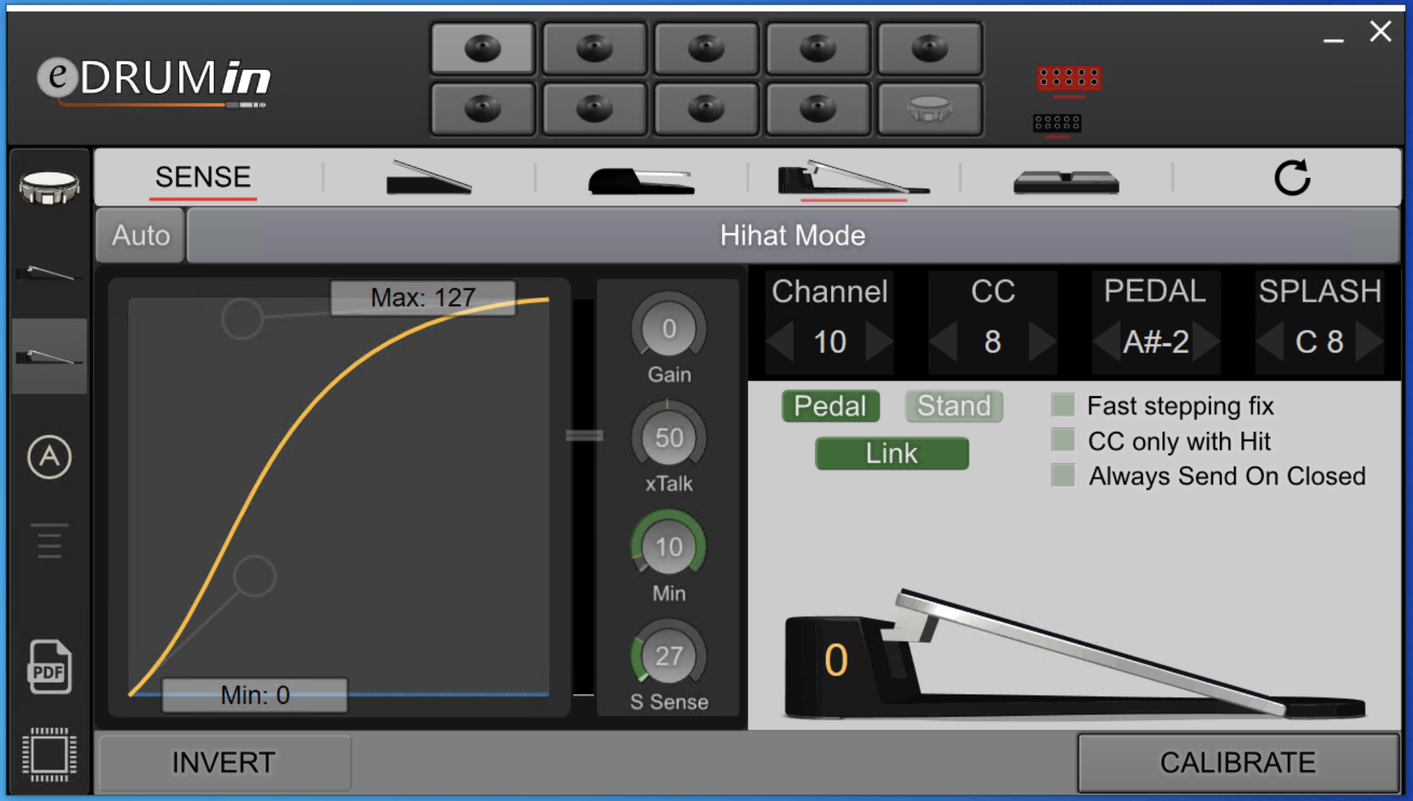

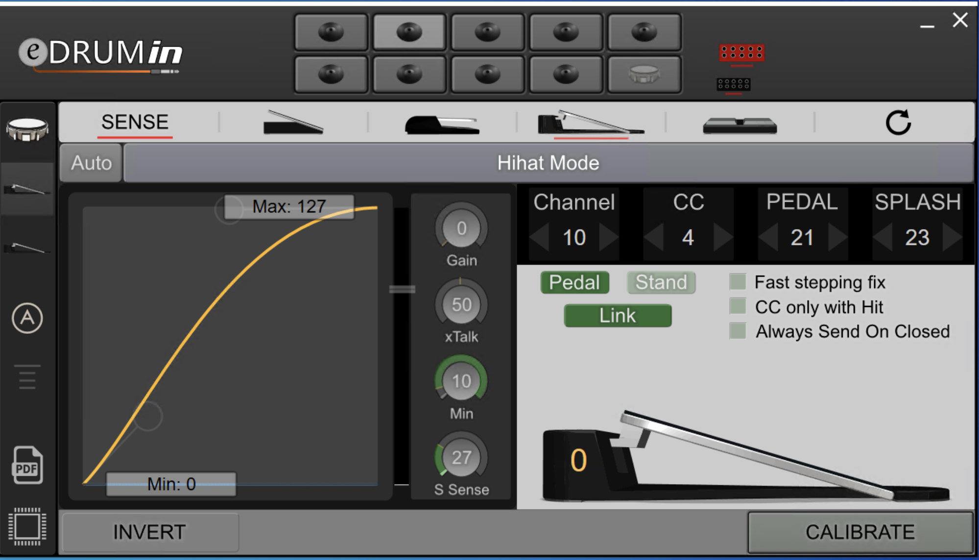

Can you also send me a screen shot of the settings for your hihat pedal?
Rob wrote:Can you also send me a screen shot of the settings for your hihat pedal?
The icon switching is only a problem when hosted. Not getting a splash seems to be a problem for me no matter what.
Pedal #1
Pedal #2
