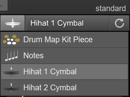

It looks like it's going to work, but to do it right, I'm probably going to need to be able to have two hihat Kit Pieces (one for each pedal input), otherwise I won't be able to completely ditch the 'link' control--more work.

I think I've got a good solution to handle assigning pads to the hihat pedals.

Rob I am not sure I understand. Does that mean that 2 mono inputs will still have to be linked to a pedal? What if I am using 1 pedal as a bank changer? I was hoping your fix would allow for 20 mono inputs with a pedal only linking to one of those. If what you are saying is that another mono input would only be linked if the other pedal was set to hithat then that would probably work for what I am looking for. Thanks for thinking about this and be willing to make changes, Mbira
Re: eDRUMin 1.6.2 BETA
Either the tip or the ring of a dual mono input can have its notes controlled by either hihat pedal.
Furthermore the change allows you to have any number of pads controlled by the hihat and allows me to ditch the link control in the pedal editor making things less crowded.
