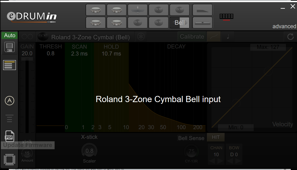

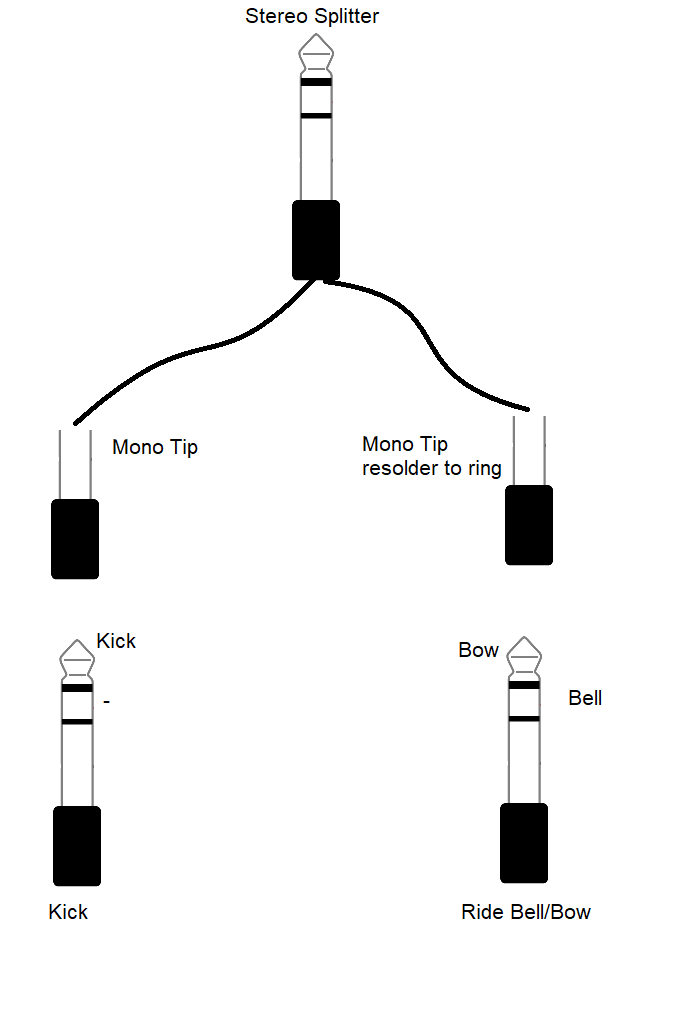

Rob wrote:Look at the input now. It's split!
Thanks for the answer. Ok got it now, it was an early presentation of the split feature. I thought it could use to assign a specific pad to the tip or the ring.
My "problem" is that I split input 10 to Kick and Ride Bell. The mono Jacks of the splitter cables usualy are soldered to the tip. The Bell switch output of my ride goes to the ring. So I resoldered one of the jacks to the ring.
So far so good. But I resoldered the "wrong" jack. It seems that the software don't let me choose which input i want to assign to the bell. Or am I missing something?
I hope you understand what I mean. It's not a big issue, I can resolder the jack again, no big deal, but would be cool if this would be possible.

Posts: 4898
You're not missing anything. The tip connection of the eDRUMin inputs are not capable of processing switches, so it has to be on the ring.
ffmcloud
Posts: 23
Joined: Sat May 15, 2021 7:04 pm
Location: Germany
Post by ffmcloud »
Thanks for the fast response, and good to know. Than I am going to resolder my Splitter Cable.
