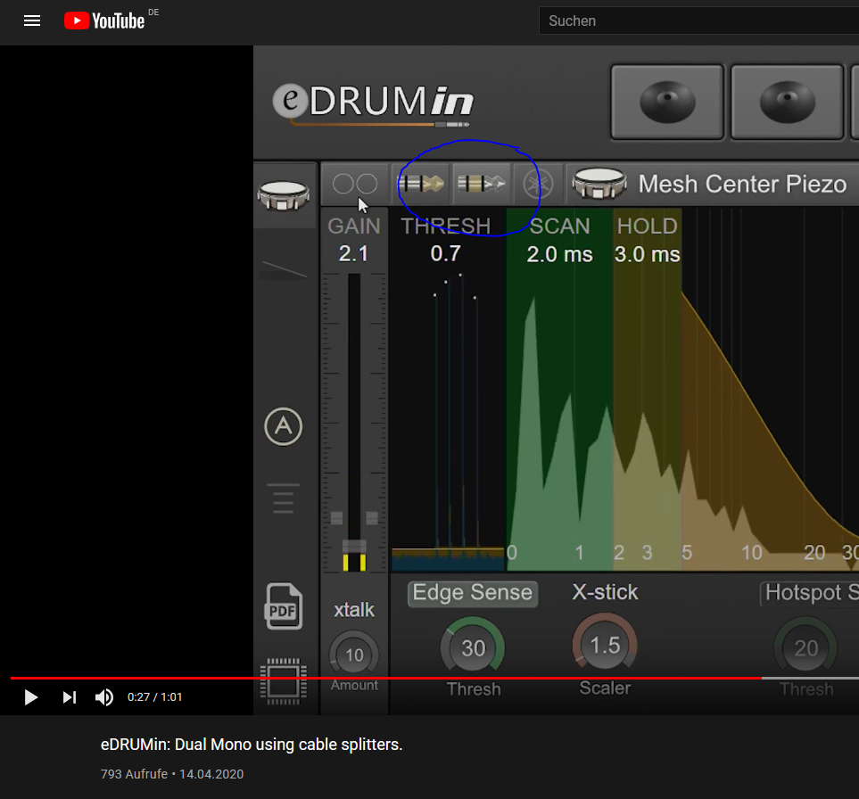

I saw a Video on dual mono and splitter cables. And there was a feature to see, where you could assign the drum pad to the tip or the ring of the input jack. Is this feature still there? I can't find it, or did you cut that feature?
Posts: 4898
It' still there. You need to change the input to Dual Mono.

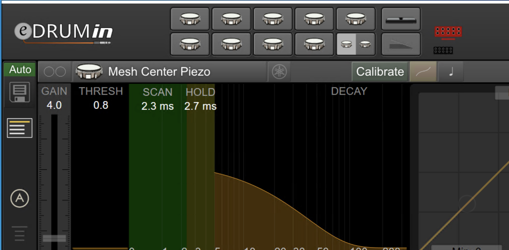

Rob wrote:It' still there. You need to change the input to Dual Mono.
I don’t see the controls to select the ring or tip either when dual mono is selected.
Posts: 4898
Look at the input now. It's split!
