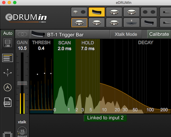

using Beta 1.6 b9, with Roland hardware, two eDRUMin10’s and SD3, I have two questions:
I have a question about tweaking for the lowest possible threshold for the BT-1 and PD-125 snare combo - using inputs 2&3. Using the Xtalk/Link mode - it works well. But…when using ‘lighter or lightest’ tapping on the BT-1, the eDRUMin app will register spikes in the THRESH box, but only trigger above some value amount - regardless - of changing both or either the xtalk setting (shown at 15 in attachment) down to ‘0’, or the THRESH (shown as 0.4) down to ‘0’. Am I missing some other parameter to adjust to try to get these lowest hits to trigger? Velocity curve doesn’t make a difference either, that I’ve noticed.
Also I noticed that I can’t link across two eDRUMin10’s for the BT-1 link. I have a 2nd BT-1 on one eDRUMin unit mounted and in tandem with a PD-125 tom that’s plugged into the other eDRUMin. I could swap around cables to get the other BT-1 to link with a PD-125, but wondering if you can change this in code, or if it’s a limitation of needing to be only within one eDRUMin. thanks!
