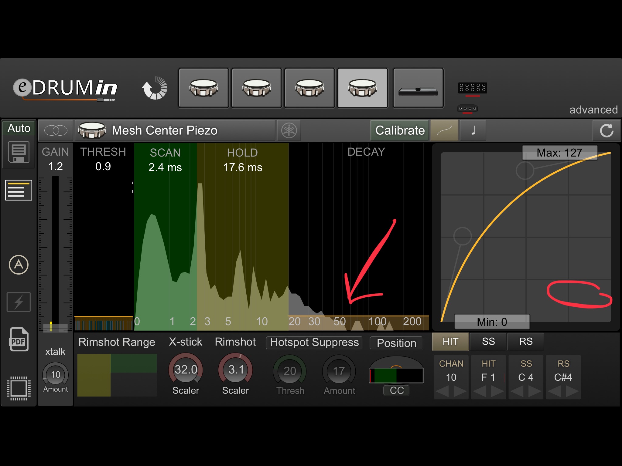

Couple of observations on the new 1.5 iOS version that was released today.
In general, it's super responsive and behaves more or less the same as the desktop version. It does seem a tad more laggy in terms of Auto-Select though.
One obvious thing that's missing however is the outgoing MIDI value display (in the curves panel). This is for all inputs.
I also noted that on both my PDX-100s (used as floortoms) connected to my ED-4 (which is connected to my ED-10), the Decay graph is a flat horizontal line that cannot be dragged or moved. Oddly, only for those two inputs (3 & 4). The Decay looks fine when viewed on desktop.
Just like I observed on the desktop, making small changes to sliders does not immediately get reflected in the numerical value display for those settings. This makes it not immediately obvious that the value has indeed been changed unless you select a different control and then move back. This makes editing needlessly tedious.
Posts: 4896
Thanks for the feedback. The velocity indicator is removed for performance reasons. If it's updated, that whole velocity curve display gets redrawn as well resulting in a much lower frame rate. I'm not sure if this is a bug with the iOS implementation of VSTGUI, but the best way to fix it is to draw less.
I think I have a solution for the small value changes. I'll test next week and investigate those bugs as well.
That’s a bummer because those outgoing velocity values are really handy.
The iOS version is especially handy in my physical situation. I can run a long MIDI cable to the rack mounted laptop w/SD3 no problem, and use a short USB cable to connect to the Control App on my iPad.
The one thing I did like about the Splashtop remote control app that I’ve been using for the past couple of months was the ability to pinch and zoom in, and make really small adjustments that way. Especially useful on a phone or tablet where one’s fat fingers are the sole means of interacting with the screen. I’m assuming that this is not possible on iOS?
I noticed the grayed out lightning bolt in the left vertical panel. Does that serve a purpose?
Posts: 4896
I think pinch to zoom on iOS might be doable. I'm not entirely sure though. As for the velocity indicator, I can probably move it Maybe it can be incorporated into the input selectors as they are getting updated already so there would be no extra redrawing. Incidentally, this iOS redraw performance issue is the same reason why I'm not very interested in adding VU meters to the velocity curve area.
