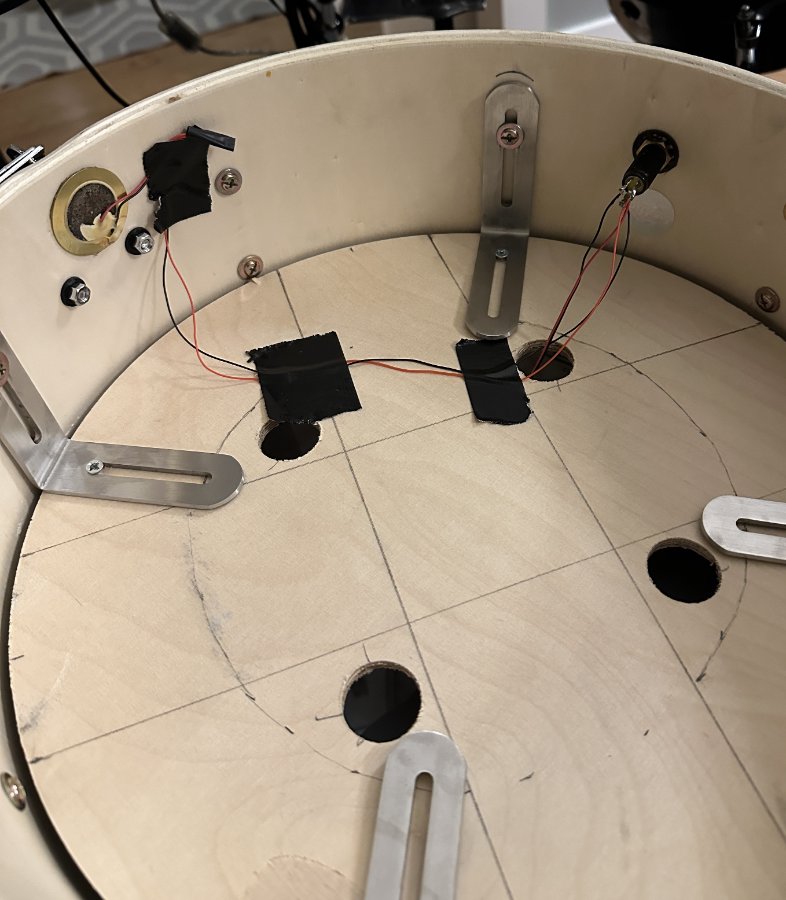

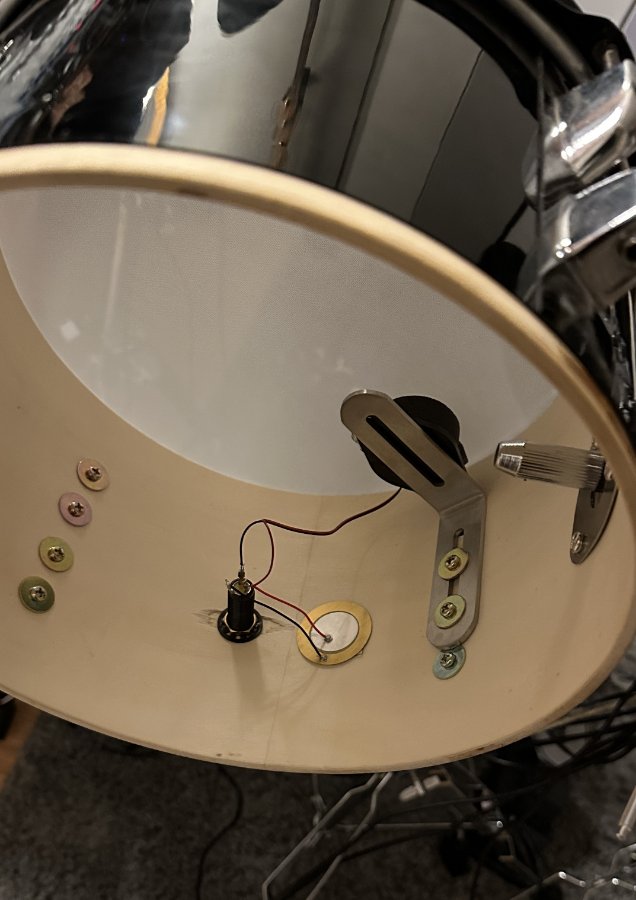

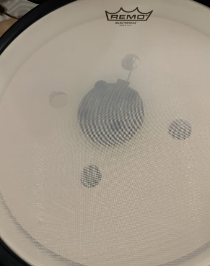

- dual zone drums. They are triggers that I took out of an Alesis Nitro kit. I saw a dude put his snare trigger into a 14" snare and it worked perfectly. It was the start of all this nonsense for me. lol. Anyway, I took the dual zone snare center trigger and the shell piezo and made a plate type setup (attached). I then took the single zone toms and side mounted them while adding a shell piezo (attached). The shell Piezo's are clipping with even the slightest touch. All three are uncontrollably loud and the floor tom make a sound that can best be described as "wooden clicks in rapid succession." I'm gonna review the wiring and make make sure they are correct (not sure if they should be Alesis wiring or Roland). I unattached them and it still has the same issues - which is weird. It's only when I change the Input mode to "Single Mono" that the heads worked fine without the insane clipping from the shell piezo. At this point, I'm not sure what to do with that other than stay at single zone for now. Tom's Ok. But snare obviously will have to be figured out.

My remaining issues are currently getting sussed out. They are:

- IMG_2655 Bottom Tom.JPG (71.13 KiB) Viewed 2118 times
- IMG_2654 Top Snare.JPG (69.99 KiB) Viewed 2118 times
- IMG_2657 Bottom Snare.JPG (99.21 KiB) Viewed 2118 times

one thing, for Alesis wiring, you have to choose "Yamaha" type pads, as the piezos are wired differently than Roland.
If the signal coming from the piezos is too hot, you will need to add potentiometers inline to reduce the signal.

Thanks Percy!
Yeah, I did the calibrate 10 times. lol. I'll try the Yamaha thing!
Is there a tutorial out there for the Potentiometer install?
