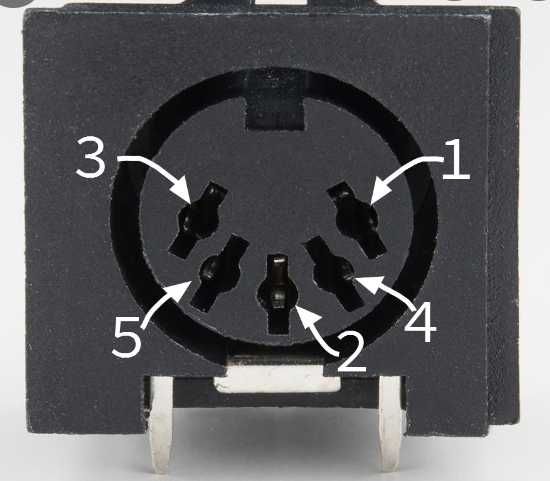

BTW is there a simple way to use an oscilloscope or multimeter to verify the specific MIDI Out power on my unit is operating as expected?
Posts: 4900
Re: Midi out powered ?
Certainly.
Pin 2 is ground
Pin 4 is 3.3V
Pin 5 is the MIDI signal
Using a multimeter between pin 2 and 4 should register 3.3V. Using an scope between pin 2 and pin 5 will should your MIDI messages. I highly doubt the MIDI Master could be damaged. There's no way it could pass EMC testing if 3.3V could damage it in any way.
