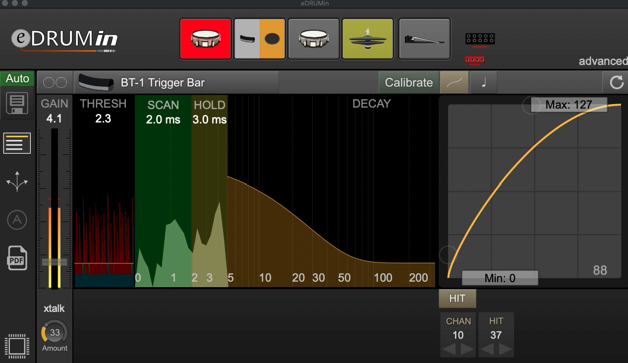

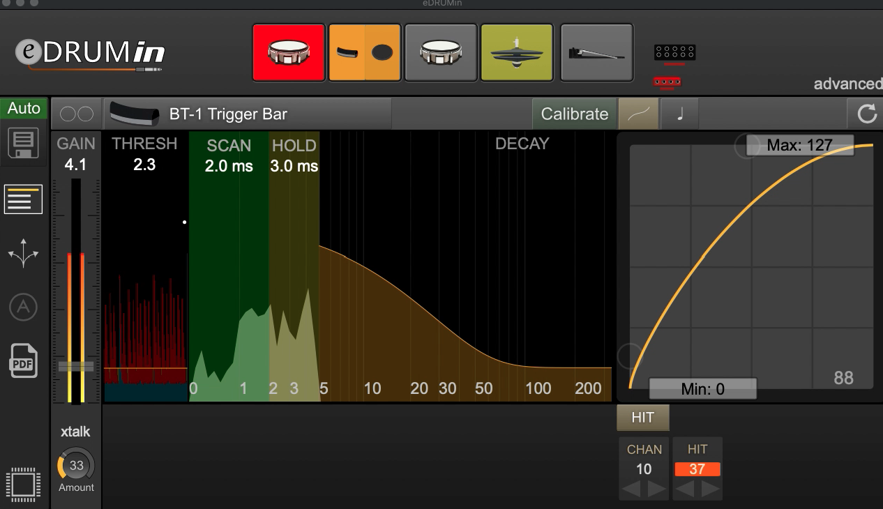

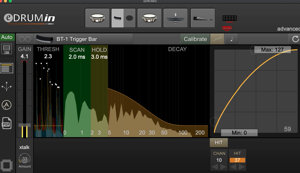

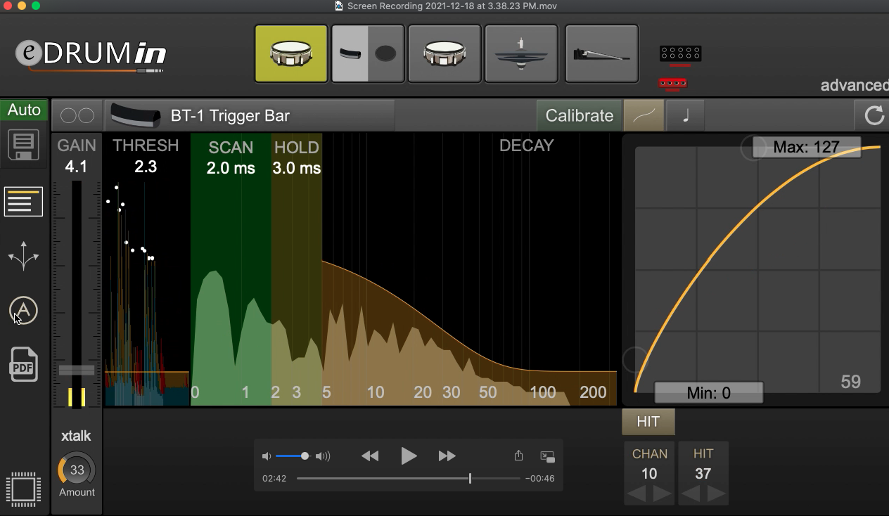

I’ve noticed since the latest fix a xtalk issue between rimshot and BT1 (sensor mode - xtalk 33) that wasn’t there before. While I’m playing rimshot backbeats about every fourth measure or so a high velocity sidestick (from BT1) is triggered. I have some screenshots I can share later today.
Re: eDRUMin 1.6.2 BETA
Dadwrshpdrum wrote:
Mon Dec 20, 2021 7:04 pm
Here are three screenshots. This is with auto select off. There is a screenshot from the beginning of the event, the middle of the event, and at the end of the event.

And here are two more screenshots with auto select on.
