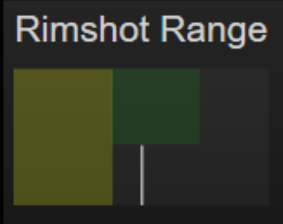

Turn the crosstalk control on your snare to 15 (currently at zero), relax the snare's decay slightly and make the rimshot range control look more this:

Hey Rob, I made those changes and it does appear to help. I find that sometimes I get the rim click instead of a rimshot a little bit easier on the snare but I can adjust my playing enough to make sure I'm striking enough of the head and the rim at the same time. If you resolve a fix for the high scalar value, even better. Thanks again for being such a big help to all your customers!

Turn the crosstalk control on your snare to 15 (currently at zero), relax the snare's decay slightly and make the rimshot range control look more this:rsr.png
